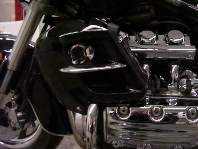

« Reply #5 on: November 20, 2012, 09:02:34 AM »
I also think what you have is not stock. Also I don't think the stock horns will be loud enough in the pods, if that is where you mean to mount them.
I bought some cheap horns at HF and put them in the pods. They are nice and loud. Mine are chrome but you could paint them black and you would probably never know they are in there.
I used the factory wire to trigger a relay to power them.
Here is how I mounted them. I used the mounts that come with them and added another piece of strapping to stiffen them up. Had to do some figuring and bending and tweaking to get them lined up with the holes right.

« Reply #6 on: November 20, 2012, 09:47:58 AM »
The horns I have look stock like those on other IS's Ive seen.
Nice pix.
