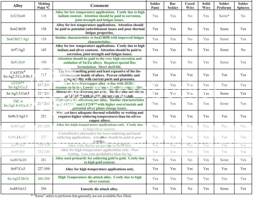

I have to believe that this is a typo in the service manual and the temperatures are 180 - 200 centigrade. 180 F is only 82 C and none of the solders melt at this temperature. That said, the chart indicates that the lowest temperature, cored, solder is CASTIN and it melts at 217 C. I think I'd either use thin, off-the-shelf solder and give it a go or take the alternator to an alternator shop and they'll know how to handle it.
