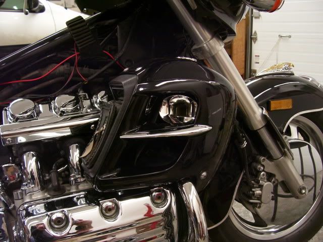

I mounted the new relay on the side of the radiator bracket inside the right pod. I cut the factory connectors off the wires that went to the original horn and spliced some spade connectors on them. One is 12 volts when you hit the horn button and the other is ground. They slide right on the new relay and trigger it. I forget off hand which terminals they go on. The other two heavy red wires.....One goes to the battery (thru a fuse) and the other to the new horns. I put my new Chrome HF horns in the pods. One on each side.
Here are a couple pics. Sorry the relay one is blurry.

Where did you get the front rotor cover?   Looks good cooldude

Bill, They came to me with the bike. So I'm not sure what they are. I don't think they are available anymore. They might even be for a different application like a Goldwing or something. The one on the left side looks like it was cut/modified to work with the speedo gear. The bike also had those big caliper covers on it, but I didn't put them back on cause they need re-plated.
Here is a link to a set that sold on e-bay. They are Rivco brand. Might be the same as mine. Not sure.

Those were made for a standard/tourer. I looked at some a while back and noted that, because of the IS speedo gear, a chunk would need to be cut out. They do look sharp!
