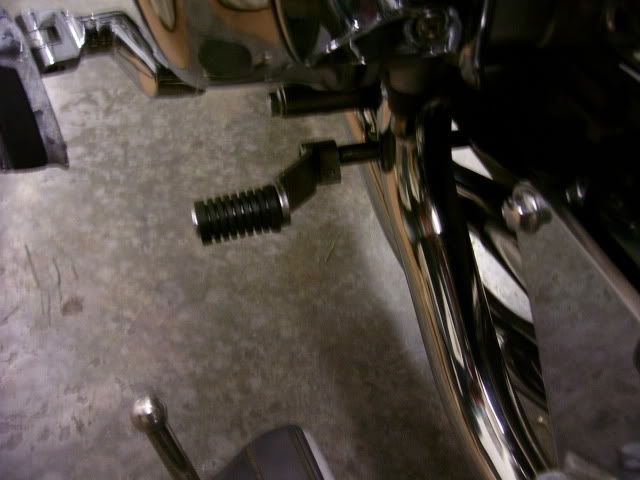

« Reply #7 on: January 15, 2013, 12:29:03 PM »
I have MC Enterprises floor boards that had a heel toe that I took off. I had space issues with the  stock shifter and floorboards. I tried the CBX1100 shifter and didn't like it because it is longer than the  stock one. The extra length actually increased the travel necessary to shift.
So my solution was to bend the stock shifter to kick it out about an inch. You have to bend each end an equal amount in opposite directions until you get the offset you want.  This moves it out from under the head a little and in effect shortens it a bit. I also cut off the guard. With it being farther from the exhaust it is not really needed. Works just fine now with boots on.
Here is the only pic I have right now.
John
