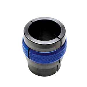

It's a reasonably task that I think you can handle.  Check the shop manual and follow the directions.  I also would suggest buying the seal driver tool from motion pro.  It is worth it. I know the pvc idea or cutting old seal and using it to "set" the new seal works but after doing a few the way I mentioned the brass seal driver tool is well worth the price.  I like the looks of this one.. Has a ring that locks it from two parts separating.
http://www.amazon.com/Motion-Pro-08-0491-Ringer-Driver/dp/B009D291C4
I'd recommend for 18.00 the fluid level tool, as well.
http://www.amazon.com/Motion-Pro-08-0121-Fork-Level/dp/B000GZPCYI/ref=pd_bxgy_auto_text_z
