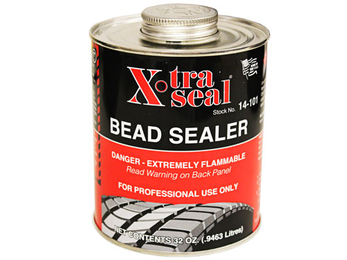

I have also had luck with hitting the tire with a heavy hammer or sledge hammer just next to the place where the bead is leaking.  Need to be careful not to hit the rim.  My only experience was with a car tire (on a car tire rim), but it did seem to work.
I have used bead seal with much success, but was only necessary when my rims were in really bad shape.  Unless there is pitting or corrosion on the rim that cannot be removed, the bead seal should not be necessary.
tank_post142 was correct:  break it down and clean the bead and the rim.
USED THIS:
TO SEAL THE BEAD ON THIS RIM
