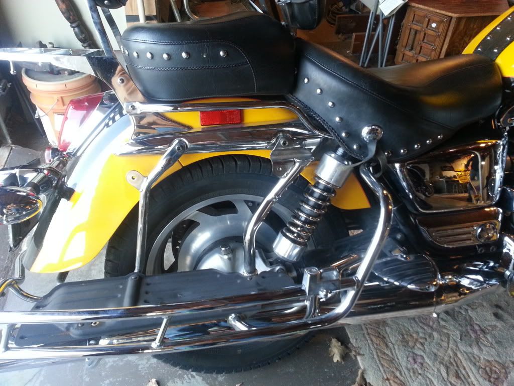

Hi all,
I bought my 98 tourer with a set of progressive 412's on it. The 412's had the standard spring on it. When I first bought it they were set on the lightest preload and would bottom out. I set them to the highest preload and did not bottom out any more. Still seemed to sag quite bit 2-3 inches when I sat on it.
 I sent them to progressive and had the HD springs put on it. I cant tell a difference. I called today to verify that they put the HD springs on there and they said they did. No other way to verify that I know of and I dont feel like spending 40.00 to ship them there and back just to double check.
I would think with the preload all the way on the 4th notch the bike would barely move when I sit on it I didn't measure but it still seems to sink a good 2 inches on the highest preload. I am 250 lbs.
So is this normal for progressive shocks. My friend has a standard with interstate shocks and it barely moves when I sit on it.
Thoughts?
