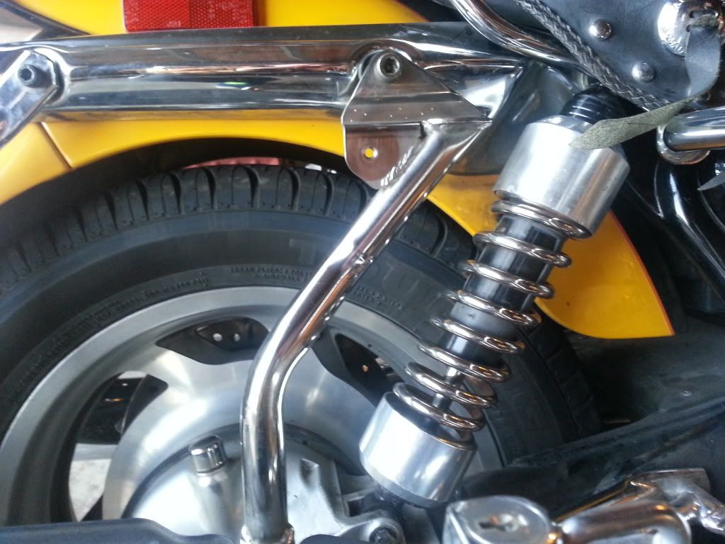

I just installed 13'' 440s. I have been running a set of original OEM 75k mile shocks for the last year. The 440s definitely ride better. They raised my bike noticeably. She now leans wayyyy over on the kickstand. I love the ride though, and don't see myself going back to OEM.
I'm unsure if my 440 springs are HD or standard. Also, they are adjusted so that 4 notches are showing on the tops of the shocks. I think this is about "medium" preload. I may be trying to adjust them soon, to make them sag a bit more, because right now I feel like I might fly over the handlebars.
