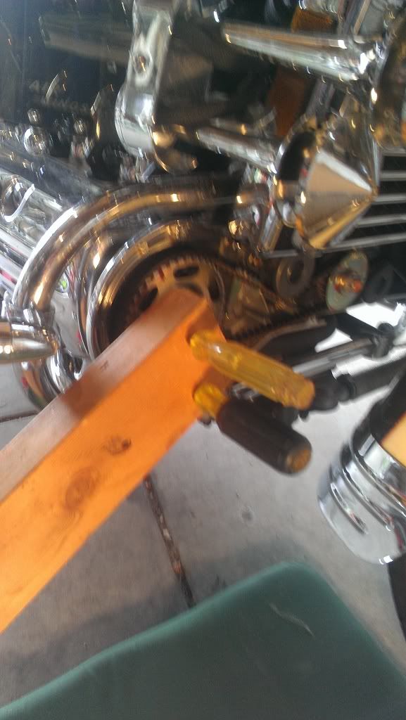

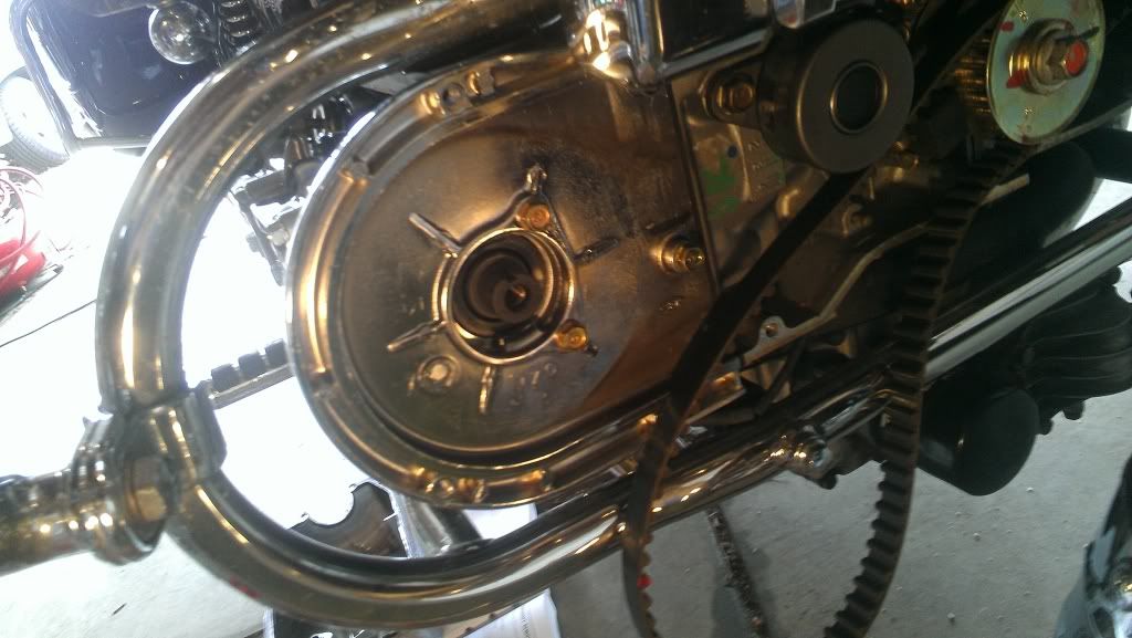

I started out by removing the timing belt cover.

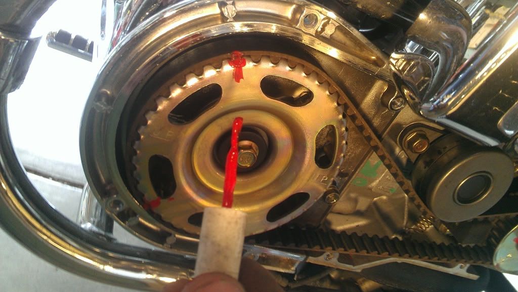

And marking the cam pulleys. I got a chance to use my fingernail polish  Grin
Then I used my universal pulley holder PN 07725-0030000 and loosened the driven pulley bolts on each side.
I only did one side at a time and started on the right.

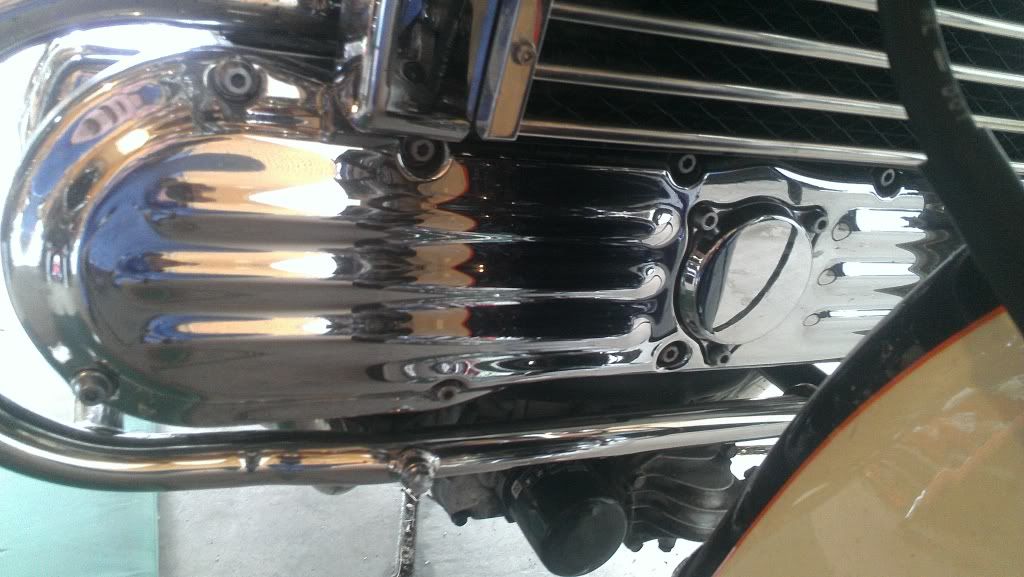

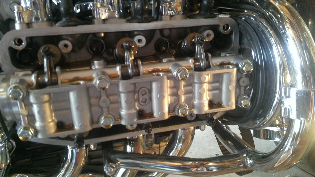

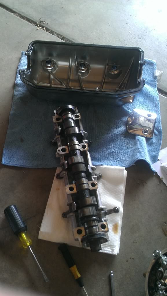

I removed the cam end cover and the valve cover.

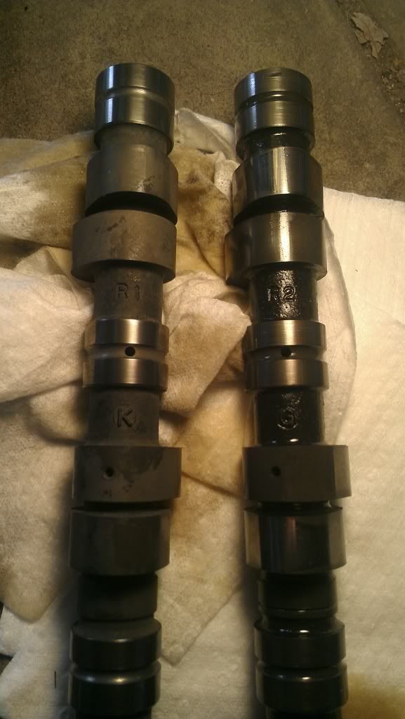

Then I removed the camshaft holder. The cam came out with the holder and oil seals on the right side. I was more careful on the left.
I couldn't physically tell the difference between the cams but the CA cam said R2 and the 49 state cam said R1.
Lubed up the new cam with a mixture of moly grease and engine oil and packed the front oil seal with grease. Used ThreeBond 1521 where the manual required.
Reinstalled everything in reverse order and then did the left side. After making sure everything was in alignment and buttoning up, I started her up for the first time. The idle was a bit lower than usual and the exhaust note was a little throatier. I didn't get a chance to ride it much, just around the block but it seems very responsive compared to what I was used to. I hope it runs like the non-Cali 1999 I used to have. I will get back with a better review when I have a chance to ride  cooldude

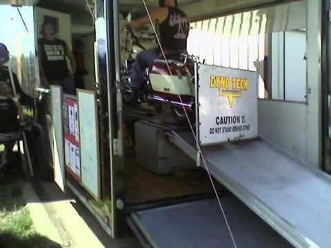

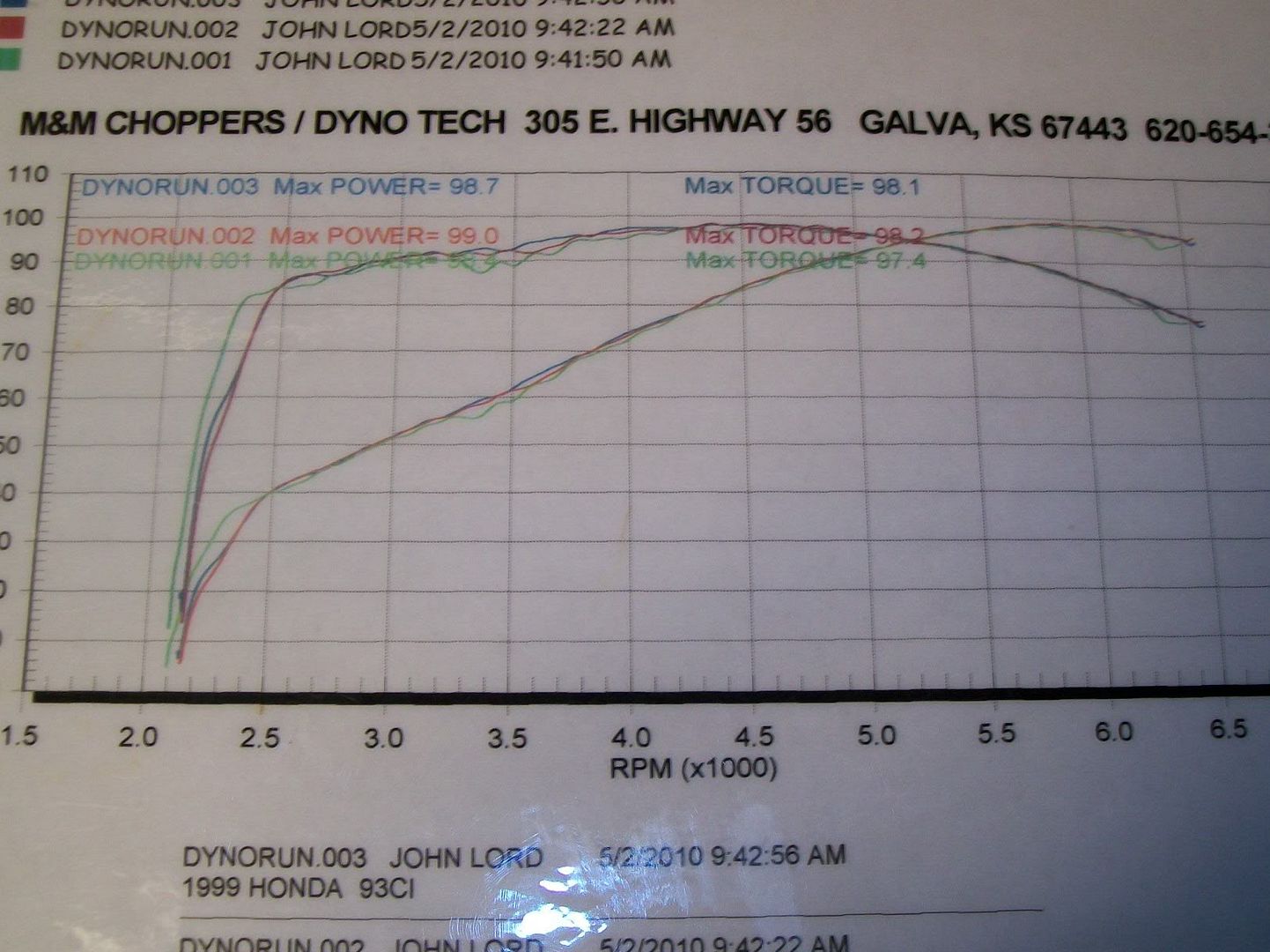

Better yet, run it on a dyno and show us.  This is my best dyno run on my 49 state tourer with the other mods you did and a restrictor tip from Grumpy on my truck stacks.   Hoser
[/URL]
« Last Edit: April 14, 2013, 07:16:38 PM by Hoser » Logged

« Reply #9 on: April 14, 2013, 11:52:59 AM »
The shop manual shows a big difference in the timing which actually can be somewhat seen in your pictures. I'm not sure if there much of difference in lift, but, that can be easily checked.
