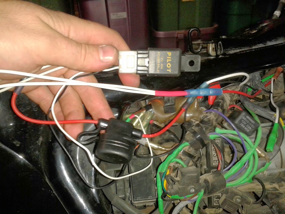

So i worked on 1/2 the project this weekend. I installed the switch block, the relay, the valves and most of the fuel line. I wanted to get it back to riding condition for the week and did not have all the parts to finish the tank install. I am hopping I will work the tank install next weekend.
Here are a few pics from the install.
I found that powerade caps are the perfect size to cover the carburetor openings.
Installed the switch block. I will install the water prof covers once they show up.
Factory fuel line removed
New fuel line with valves. I left out the fuel filter since the one I got was to big. I think if I get 2 small ones I could add one to each side right before it connects to the carburetors.
Fuel line and valves installed
I used pull apart connectors covered in shrink wrap. That way if i need to remove the valves I can just cut the wrap off and they will pull apart.
I used a relay I had setting around to power the switch block.
2nd Valve for aux tank under current fuel valve.
Temp plugged fuel line were I will add a manual shut off valve that will run to the aux tank.
After I got it all back together it fired right up ready for another week of commuting to work.

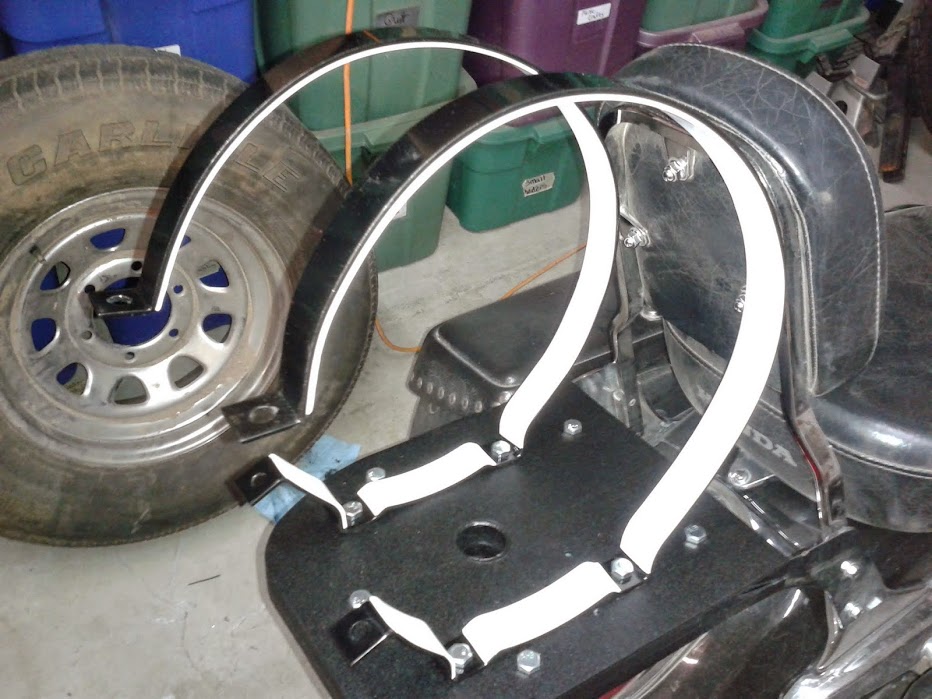

So I needed to extend the rack a bit to make the tank fit. I used a scrap peace of aluminum and stole a cutting board from the wife
for my base components. Started making templates and cutting.
Cut the hole for the fuel line.
Started cutting up the cutting board
Had to grind the pegs off the bottom of the existing rack
This is the initial stack up. One Aluminum and two cutting board.
Test fit tank
Cut the corners off the new rack
Painted the tank and rack black with Rust-Oleum Bed Liner.
Mounted the tank mounts
Tank mounted
Routed the fuel hose
Added a shut off valve and added a filter

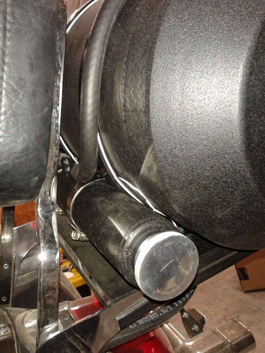

I also started working on the catch can for my vent line.
This is what I started with. It is a radiator reservoir tank I picked up on amazon.
Started cutting
Drilled holes for the vent ports
Used some J-B Weld to hold it together
Used the bed liner to paint it black
Started working the tank mounting bracket. It will go under the 2 straps currently holding the tank on then will have places for 2 house clamps to hold the catch tank on. I used two pieces of aluminum J-B welded together
That is as fare as I got before I had to start getting ready to head to work.

Finished it up today for now.
In the future I still might try to find a leather bag to put it all in so it just looks like luggage.
I will also need to figure a locking gas cap.
But for now it is done.
Painted the can mount bracket
Mounted the can
Ran the vent hose
