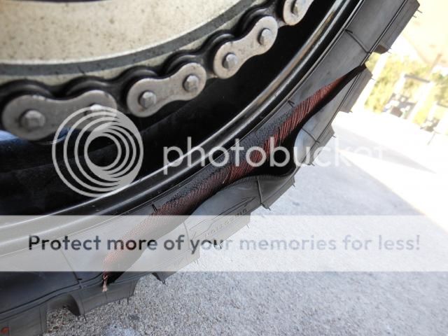

Awhile back I went to check the air in my front tire and found out the rubber base of the oem stem was cracked. Still had the plastic brace on it that attaches to it too. I got to searching/reading through all the back posts on the Metal Stems. Found out about changing them with the C-clamp method. Took me a couple hours to finally get it all figured out and finished, as it was the first time I'd ever done it. Finally used a Ratchet Strap and found out my 3 gal, 100lb compressor also had the attachment I needed. Straight through with a trigger. Took the valve stem core out, snugged up the ratchet strap around the circumference of the tire, screwed the airline attachment onto the stem, pulled the trigger and "POP", bead reseated and I was good to go! Back tire doesn't leak, but I'm gonna replace that one too, just for my own peace of mind.
Gotta do what you gotta do... I once used a ratchet strap to help re-bead a (much smaller than our
Valkyries) lawn tractor tire.
It worked great, but when the bead took - POP! - that strap was scary tight...
