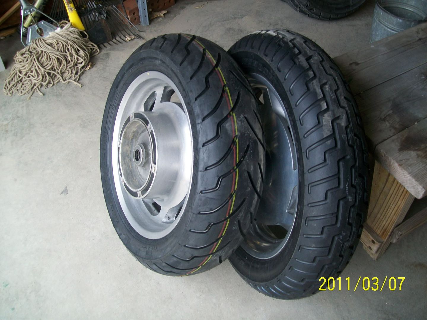

Been running the D404 front with GYTT on the rear of my 98 Tourer. Haven't tried one on the rear. Some mileage readings were lower I changed tires before long trips not wanting to bother on the road. This is my 4th front getting 13K to 19K
I'm pleased with the performance handling wet conditions very well.
Here's my combination.
