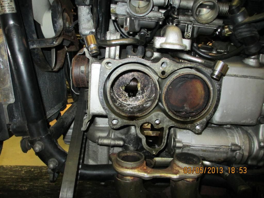

Geez, you guys are like an impatient virgin! Grin So far there isn't much to show but I'll put up what I have thus far. Basically, the bike has gone from this(the one on the left):
To this:
And this:
The steering head bearings are the same for the Valk and the 1200 so I'm using a spare set of Valk triple trees. They're wider, heavier looking and looks kinda neat up there. My friend Bill Gurney(Grumpy) in Tampa is going to turn out a spacer to use on the stem since it's a bit longer than the 1200. I have sourced a front Valk wheel and already have the calipers which I'll rebuild before mounting. The 1200 rear wheel will have to be used due to the diameter of the axle...it's smaller than the Valk. I discovered the drive flange from the Valk will fit the final drive on the 1200 which would allow me to use the Valk rear wheel...except for the axles size. I can't use the Valk final because the bolt pattern doesn't match on the swingarm. To use it(Valk s/a is too wide by quite a bit), I'd have to cut off the end of both swingarms and weld the Valk end on to the 1200 s/a. Too much $$ to mess with it. The tank you see in the pics is from a Valk Std. and is just sitting on the frame for now. I needed it there so determine if the handlebars will clear using Valk stuff....which is does. I've sandblasted the frame, swingarm, and centerstand. Soon as I weld in some new mounts for the tank, I'll be sanding them all down and priming them. Later today I'll try to remember to take a couple shots of the forks loosely in place, probably try sanding them down a bit first. It appears they were "flash chromed" because it's real thin and sharp as a razor blade due to the peeling. Right now they're quite ugly, we'll see what the day brings.
