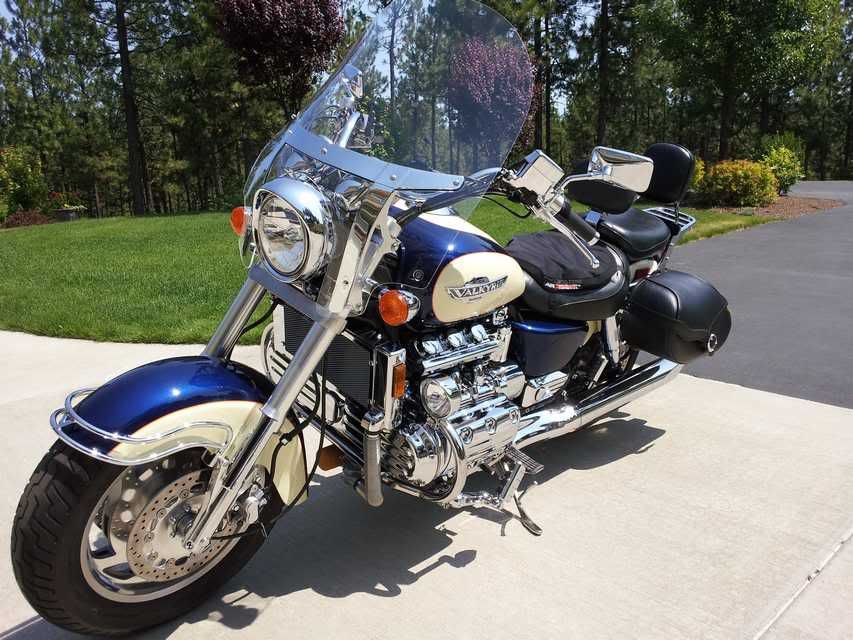

I replaced my OEM with a 21.5 inch Clearview windscreen and no vent. It's a quality procduct. My only caution is that when you install it don't tighten the fastners alongside of the headlight to tight or you will pucker the chrome. The reason is that the CV shield is thicker than the OEM, however if you shim at those points all is well.
« Last Edit: May 18, 2013, 05:56:36 AM by salty1 » Logged
