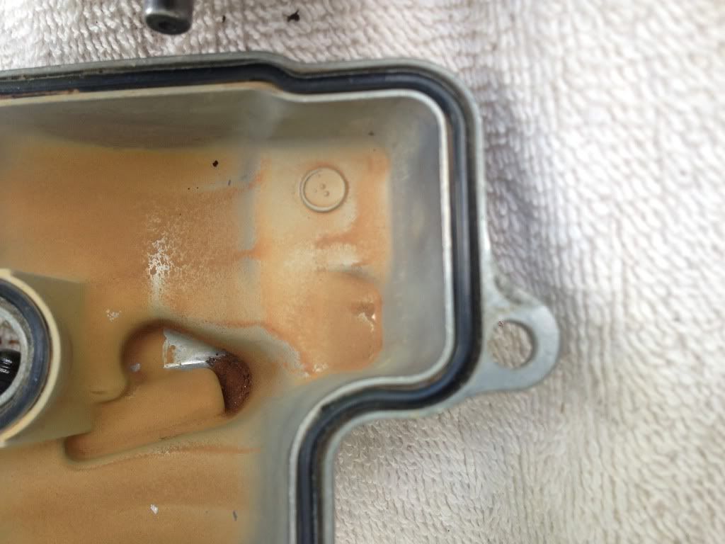

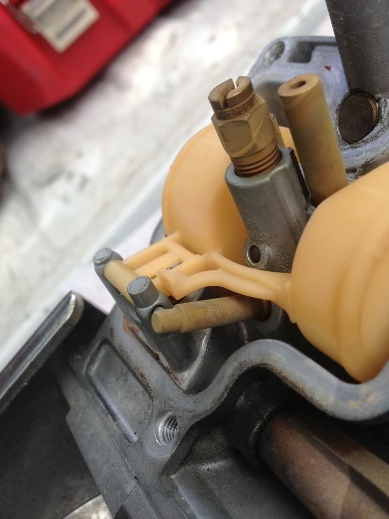

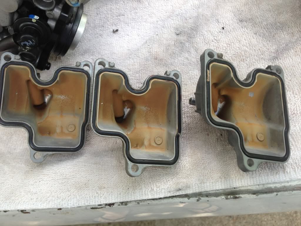

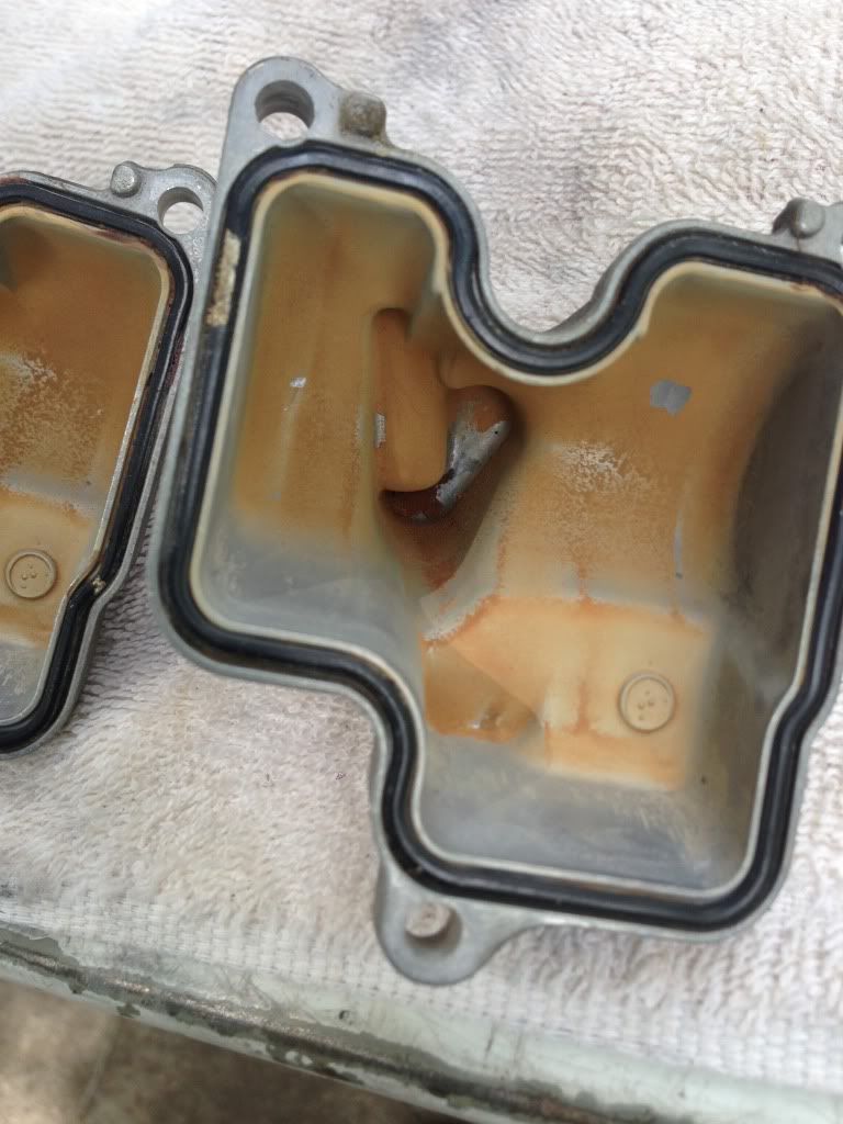

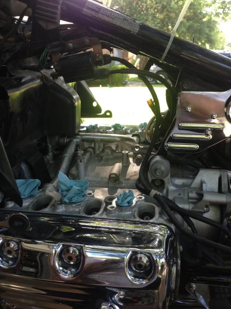

I took her down for a lung transplant (carb replacement).  I just happen to have a set of stock IS carbs and thought while I have her apart for paint and body work, I would swap the carbs.
Looks like I have the stock jets, both low speed and the high speed jets.  100 on mains and 35's on the lows.
Now I need some advice.........

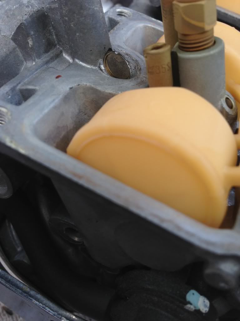

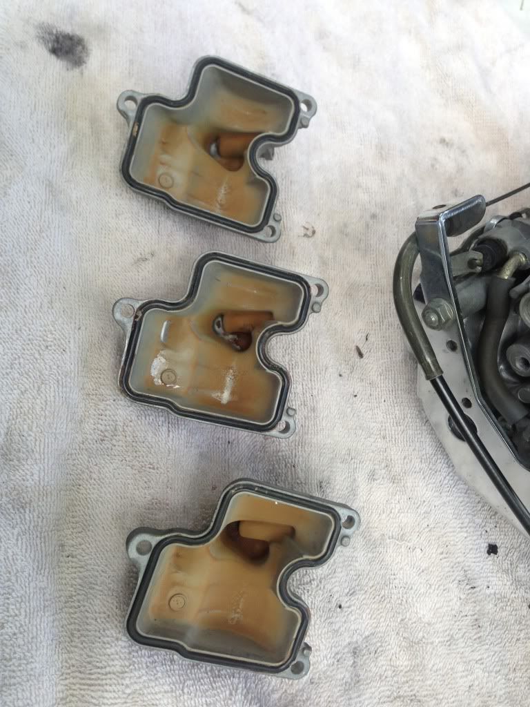

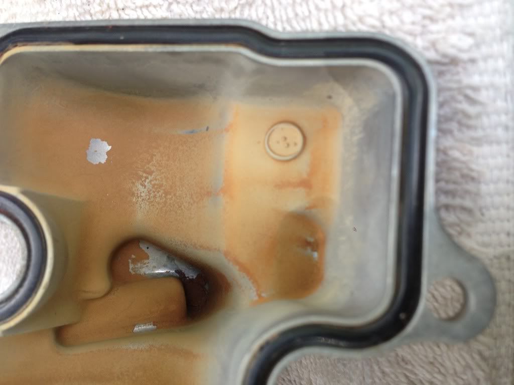

The bowls and jets are covered in what looks like very fine dirt or rust.  Since I have the tank off and drained, should I rinse it out with something in an attempt to get any residue out of the tank?  The carbs I am replacing the current ones with are clean as a whistle and I sure don't want them ending up like the originals if I can help it.  Here are some pics.
2,4, and 6.
1,3, and 5.
Close up.

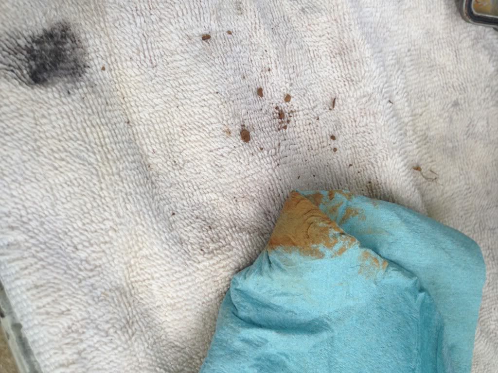

Here is what tapping the bowls on the towel and what the stuff looks like when wiped out with a blue paper towel.
Nasty huh?
What do you guys think?  Rinse the tank? And if so, what to use?

that doesnt look like rust to me it looks like the varnish/residue from gas that evaporated in the bowls (ive seen the same stuff in the carbs of the small engine equipment at work after sitting all winter) how does the inside of the tank look? is it covered in the same stuff? i dont think you need an acid at all to clean it out if you do id just soak it with fresh gas or maybe some good carb cleaner till it comes clean.
« Reply #3 on: June 02, 2013, 05:27:48 AM »
The bike was running fine with those carburetors wasn't it ? From what I see in your pics is normal and it should clean right up. All metal fuel tanks will develop some rust so I just rinse them out.

Check the tank for any signs of rust. I agree with the others in that The residue looks "normal" after extended use. If you need to remove rust, use a product called Evaporust available from Harbor Freight. Its paint safe and works well as directed. Be sure and clean your jets while you have your carbs apart. If you have any stubborn residue use some "Brasso" to clean it up and then rinse it with carb cleaner.

I do carburetors on a daily/weekly basis, mainly in the marine industry.
I see the same exact residue in bowls where the fuel tanks are made of plastic....no rust!
Residue comes from repeated evaporation of fuel from the carbs.

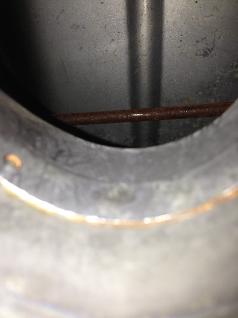

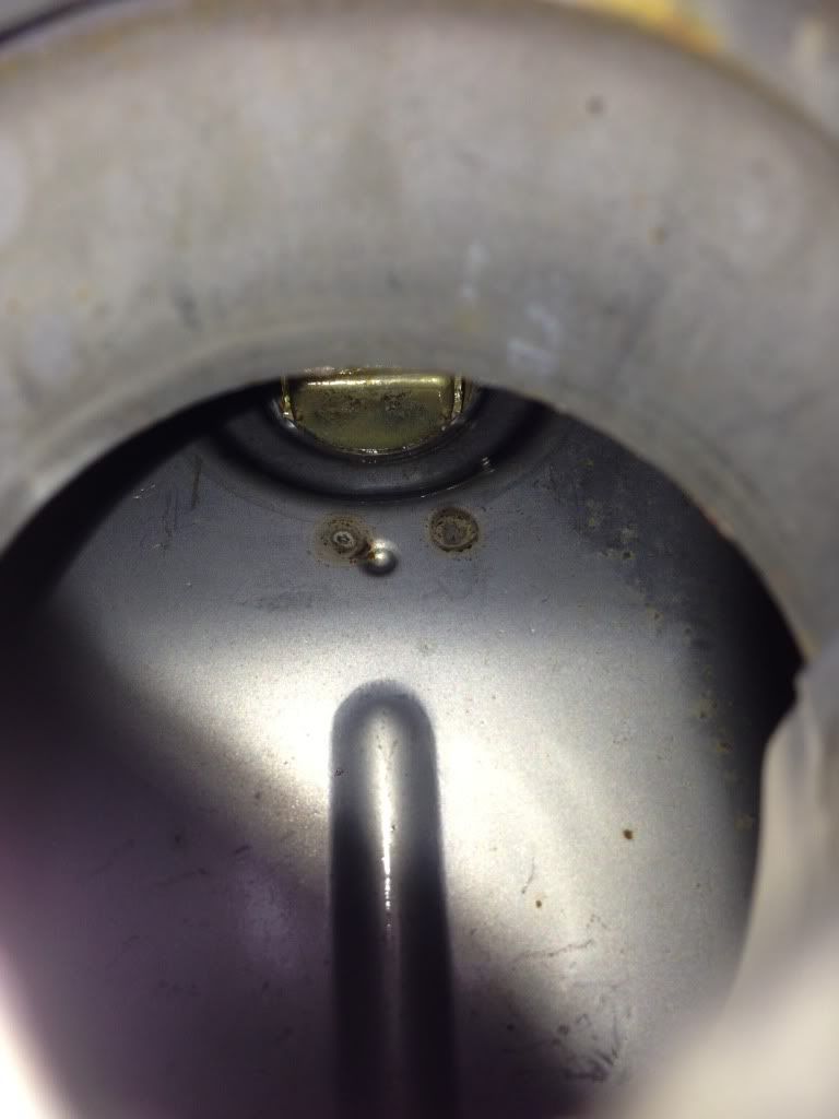

Inside the tank, the ridge that comes up in the middle of the tank looks brand new.  The tube, that I think is the metal vent, is coated with a rust like coating.  I will take a picture down the fill hole and post in a few.

That residue is organic matter and should wash out with hot water and soap.
Typical results from continuous use of ethanol enriched gasoline.
For the gas tank I would only shake it with clean gasoline to dislodge what can be shaken loose and pour it out from the fill hole.
Any thing remaining in the tank will cause no trouble.

Hey HayHauler,,, while you may or may not have a bit of rust in the tank,, it wont be much considering you said the center looks like new,, I don't think what is in the carbs is from the tank. Like everyone else said, what you are seeing is about the normal amount of residue from our crappy gas for 110K. Clean them up,, they will be good to go. I'm afraid the carbs that are "clean as a whistle" will look just like these one in 100K miles. Run a bit of Barrymans through the fuel every now and again,, it may help.

Well I took a few pictures of the inside of the tank and everything looks fine.
Here is the inside of the tank that shows the tube that connects the two sides of the tank.
This shows the shiny inside of the tank.

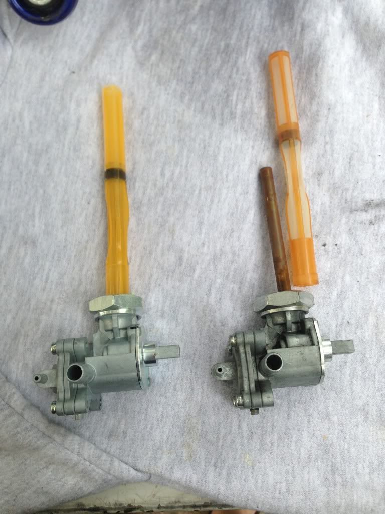

Here are two petcocks.  Left is a brand new one and the right is the one with about 20k on it.  There is nothing wrong with my petcock.
I put a half gallon of gas and 4 ounces of Techron on the tank and swished it around.  I dumped the mixture into a clear bowl and there were only little chunks of stuff in there that would have never passes thru the screen.
I swapped the new petcock for the old one and will keep the old one as my good spare.
