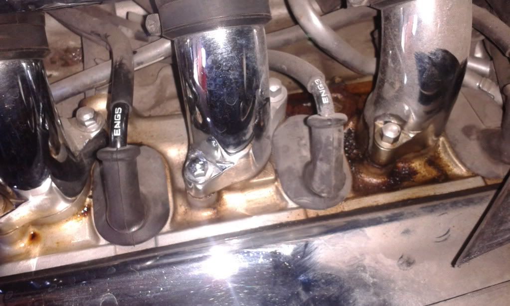

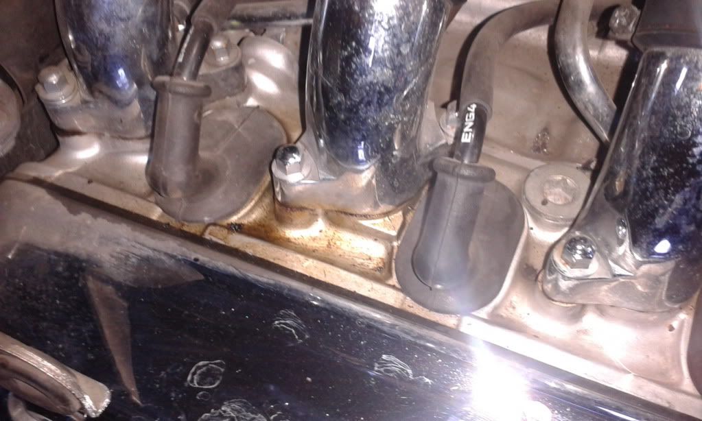

Just saw this oil leak on my bike today. Thought is was on one side, but it seems to be on both sides.

It was hiding behind the pods. Right side is worse than the left. Not sure where its coming from. One of the gaskets maybe?

Intake O'rings perhaps?   Undecided

Yep. Intake O-rings. That is fuel deposits, not oil. Easy, cheap, almost fun fix.
I had similar looking smudge on my intake manifolds surround the outer side of the o-rings where they contact the head. It was the o-rings causing it. I am not sure why it looks like that, gas + water + dirt = who knows what ya get, but the Viton O-rings that red-eye sells are very well priced and are a very easy starting point mechanically.

OK, so I'm guessing  remove the two bolts on each then pull intake off replace o-ring then reassemble?

« Reply #6 on: June 12, 2013, 01:57:33 PM »
 cooldude +1
Been there, done that, looked exactly the same.
Real easy to do.
Good luck

« Reply #7 on: June 12, 2013, 01:58:05 PM »
Yep.

« Reply #8 on: June 12, 2013, 02:00:39 PM »
Just to add, loosen clamp on rubber manifold piece, no idea what its called.  If doing more than one at a time, stuff shop rag in intake to avoid dropping a part into the cylinder.

« Reply #11 on: June 12, 2013, 02:14:43 PM »
That's almost finger tight!  Get to try out my new torque wrench.

« Reply #12 on: June 12, 2013, 02:28:25 PM »
+1 to both recommendations. I believe they are called manifold or carb insulators, and you will want to remove the carb link cover (3 phillips head screws) to get better access to loosen them up.
edit - if you want to remove them with the manifolds, not needed. just loosen the bottom band clamp.

« Reply #14 on: June 12, 2013, 08:19:59 PM »
Very easy to change the intake O-rings. Just loosen the three clamps on the rubber, remove two bolts on each intake and pull out while lifting slightly. Nothing else needs to be removed from what I see in the pic you posted. Do all three on each side while the clamps are all loose, this gives you just enough slack to make it easy to remove and replace the intake tubes without screwing up the new O-rings. I put a lite coating of dielectric lube on mine to make them slippery or use a dab of grease. Get the dielectric lube from Radio Shack or auto parts store.
