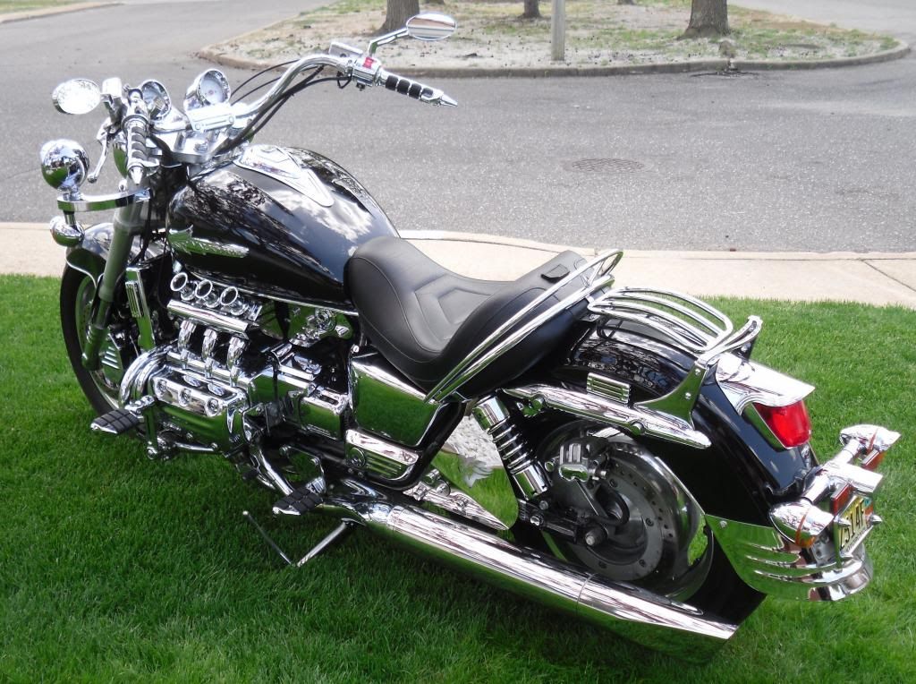

I am also interested in any comments anyone has I have a 03 standard that I just desmoged and changed my slow jets to #38s with a k&n air filter . I have a dana 3000 icu that I haven't installed yet and was wondering should I change my trigger wheel to a 4 or 6 degree upgrade  I allways use premium fuel and ride solo any comments would be helpful
