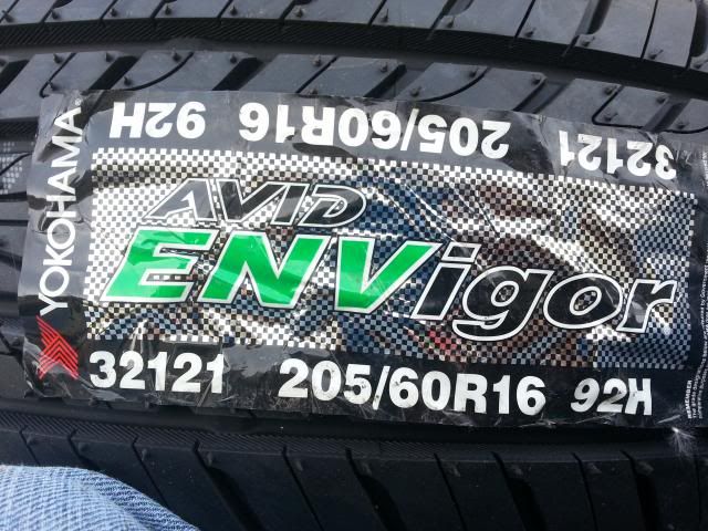

Just ordered this one
http://www.tirerack.com/tires/tires.jsp?tireMake=Yokohama&tireModel=AVID+ENVigor+%28H-+or+V-Speed+Rated%29&partnum=06HR6ENV&vehicleSearch=false&fromCompare1=yes
I like the looks of it, and have yet to see anyone have an issue with it on this board.  We will see next week!

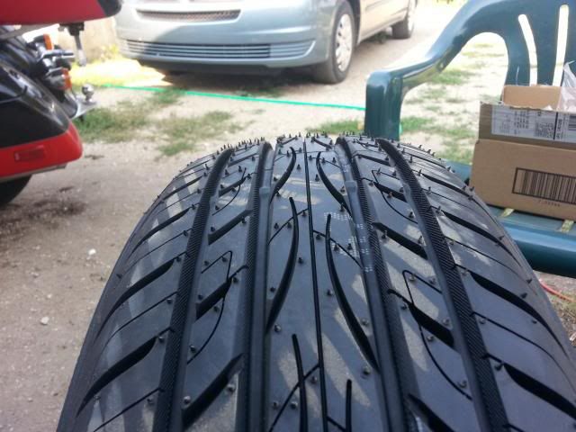

This was waiting for me when I got home Tuesday.

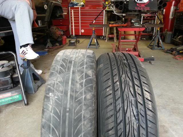

I really liked the profile of this tire when I saw it in person.  Even better than in the pics at Tire Rack.

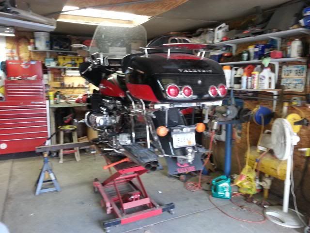

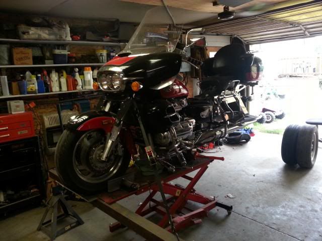

So, time for the bike to go up on the lift again.  Getting the bike on and off the lift is always the scary part for me, but, I managed to get it done with no issues once again.
Old tire, you have been a great friend and companion the last 16 months, but its time for you to meet your replacement.
And then the fun started.  The guy with the tire machine that I had planned on doing the mount and dismount of the rubber parts took off for a 4 day trip on his bike to Milwaukee.  That sucks when its already at this stage...
So improvised, and with some help from my 30 ton H frame press, I had the rubber broke loose from the tire. Now it was time for the real fun to start.
But it was not near as bad as I thought.... In all actuality, I bet I was done in less time than it would have taken to drive it to town, have the rubbers swapped, and take it home.  And I still have my 25 bucks in my pocket, and my gas money.  I also now know how to do it easier than i was before, and I know i can rock it out on a weekend when everything is closed.  I will use some dyna beads to balance it out, and I replaced my "new" stock valve stem with a steel bolt together job.

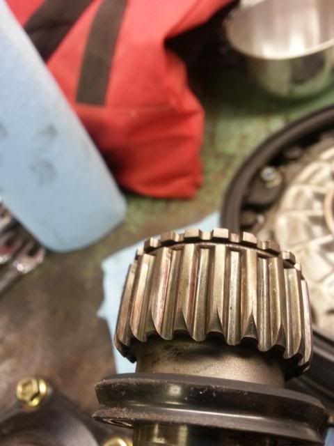

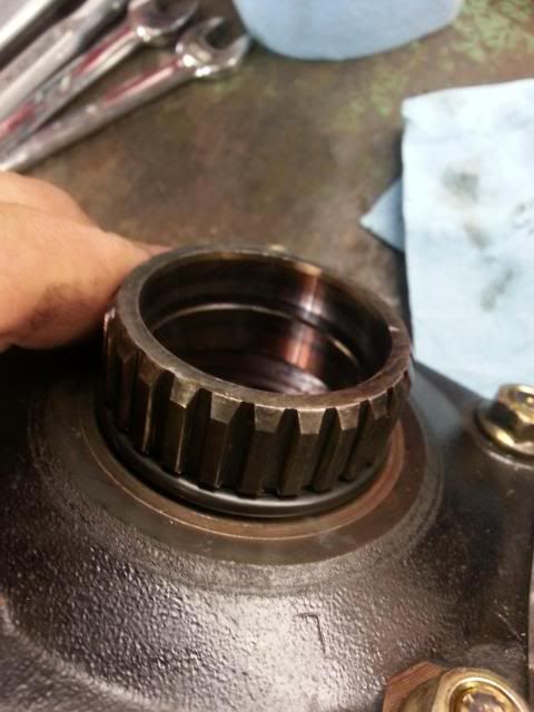

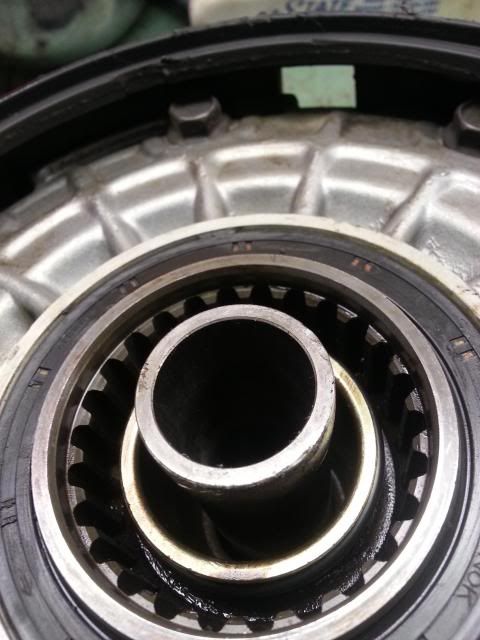

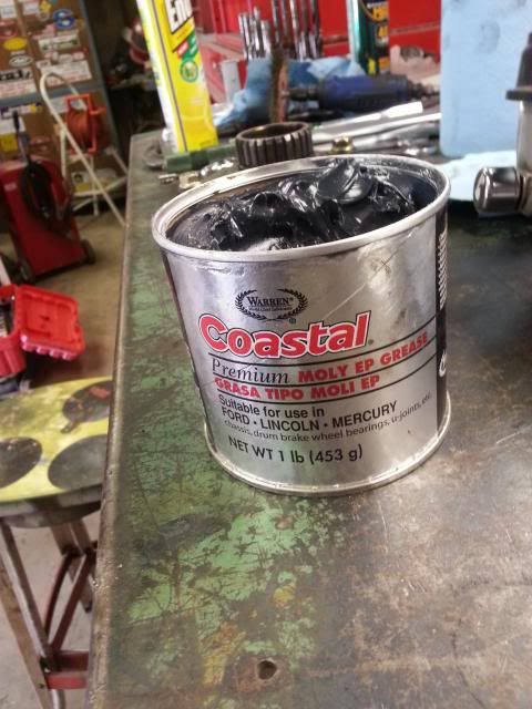

Next came the greasy bits... I wanted to see if my Moly infused grease was still holding up.
I would say it is.  At 41k, I have very very little wear to the splines in the rear end.
Almost no visible wear on the wheel hub.
And just starting to get a touch of wear on the drive shaft.  The pinion cup still looked great, with hardly any visible wear on it.
I took my time, and cleaned the shop before I even started. All went pretty smooth, and I was start to finish in about 4 hours.  I know I have done it alot faster before, but today I had nothing really better to do, so I took my time and enjoyed myself.
I was also doing some trial and error type stuff as I went.  Always before, i took the bag supports off.  With the hitch, that becomes a PITA, so this time i just pulled the bags and realized with the support bars that will made, i can pull the axle out no problem above the muffler and the bag support.
This little bit of knowledge will also be handy when doing Johns bike next time.  With his hitch, it makes it a great time getting the bag supports and the bag rails all back into place.
The drop tail lift already makes it so I no longer have to pull the rear fender, and that is a big help.
