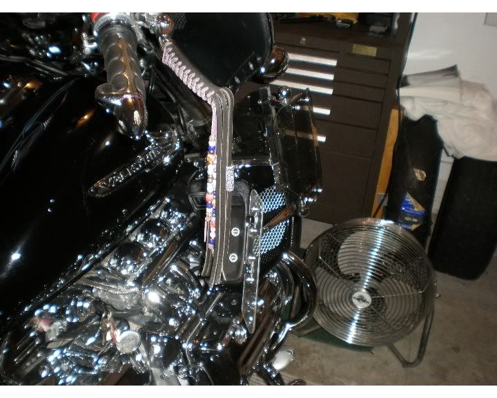

I see many seem to like the airwings. I have never used them. What is the advantage? Direct airflow to you? Direct airflow away from you? Does this re-direct engine heat? Keep you warm in colder climates? I thought it was a Wing Thing? ???

well, before i got mine i didn't know if i would like 'em so here's my thoughts.
they deflect the air away when it's cold, and "pool" the engine heat around your legs.  when it's hot you can turn them to catch air and divert it directly onto your legs.  when it's raining you don't even get wet when they're closed.

No one has yet mentioned one of their most valuable intended uses IMO, which is to greatly reduce wind buffeting to both you and your passenger. In the summer heat you can turn the bottoms out to direct cooler air  towards yourself and or passenger and leave the tops to reduce buffeting to the chest and head area.  I have taken them off a few times to see if I can live without them, cuz I'm not particularily enamoured by the looks of them (FUGLY), But I always end up putting them back on cuz they work (form follows funtion I suppose)  cooldude

On a Std or Tour the bakers have two wings.  Summer close the top and open the bottom, does two things, directs air into your body and stops the buffeting.  Interstate only have one wing with an inner air dam that I remove for summer riding.  Also they are useful when you get caught in the rain.  Ive been using them since 98 when I bought my first Valk, and even though some dont like the way they look, I believe anything that is this functional is beautiful.

I have both.  The radiator deflectors and the Bakers.  My I/S is a 2000, bought in March of 2000.  During the first summer I got the radiator deflectors because I noticed that the faster you rode, the more the heat coming out of the pods would get closer to my legs until at interstate speeds when the hot air then touched my legs and then came straight up into the cockpit area.  Those deflectors helped to push the hot air outwards.  When it got colder. I could adjust them to get the hot air to come up where i wanted it.  Even with those it was still too hot, so...I'm at the 2001 VOAi ride-in in La Crosse, WI.  Talked to Mr. Baker himself about his product.  He put them on and told me to go for a ride and if I didn't like them, he would take them off and give me a refund.  It was very hot that weekend and I didn't get 3 blocks before I decided I wouldn't be returning them.  Both sets of deflectors work well with each other.  I also have Hondaline fork deflectors.  When it rains, I hardly get wet.
