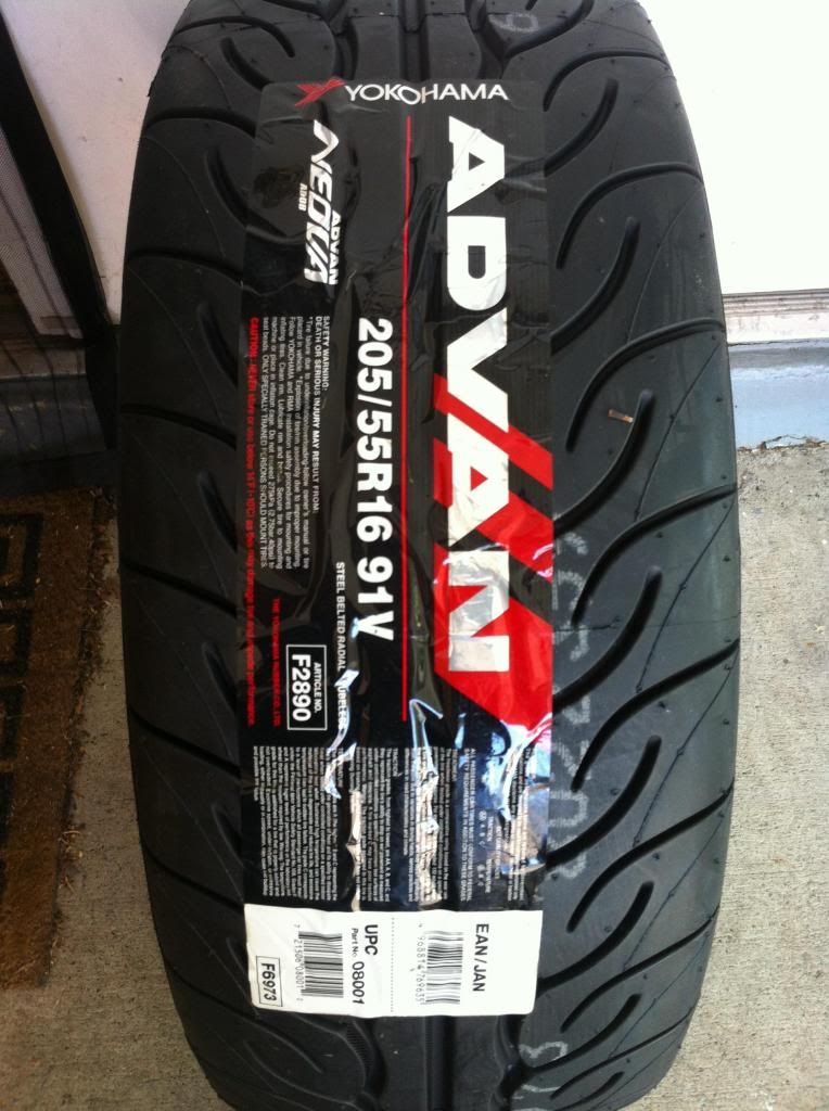

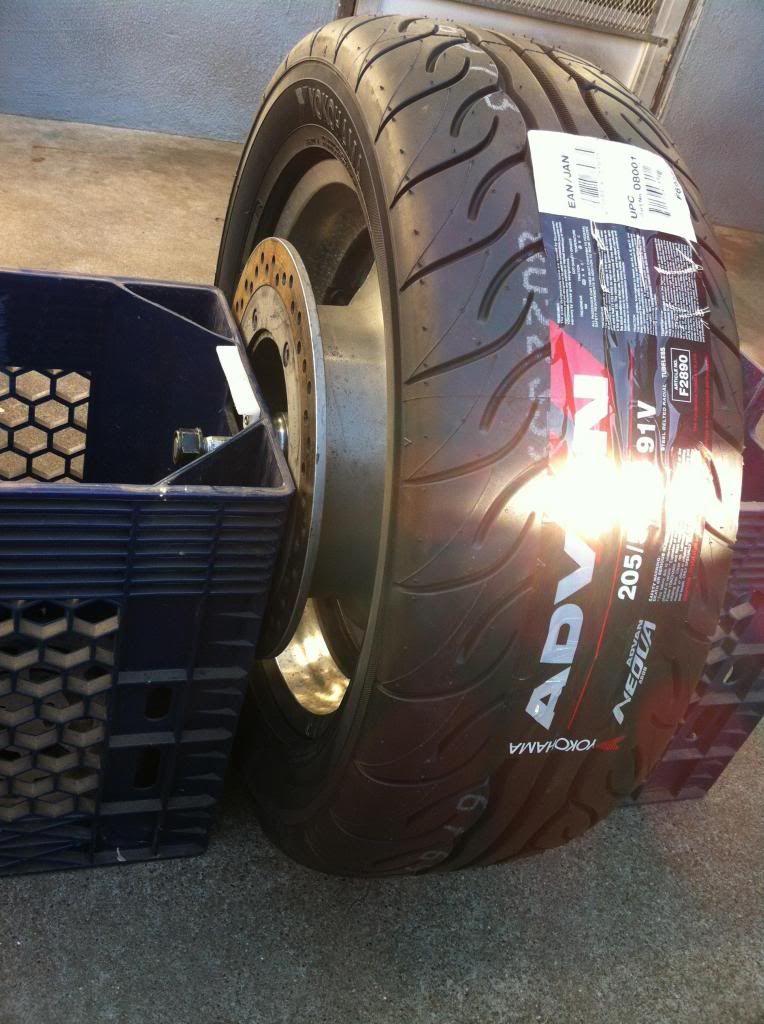

Well,,,,,,, The new tire showed up today and of course I got overly excited and did not spin the rim without the tire installed. Just wiped the rim off a bit more and headed to my regular tire guy not a M/C specific shop at all. Actually they NEVER work on bike stuff. But they installed this C/T on my M/C rim for me since I have been shopping there for just about 33 years now. No charge, but they also couldn't balance it for me either.
Just for clarity since I noticed it was mentioned the different usage for Ride-On and DynaBeads. I was only running Ride-On and if you check their site they specifically say does both dynamically balances and stops leaks.
And that was your Tire PORN for the day.... Evil Evil

Yeah nice tire, but you are still going without knowing what the situation is,,,,,,,,,,,  do a static balance to at least get in the ballpark and make sure there is not a gross out of balance situation.......  you had too much weight before to make it come out, I would want to investigate to make sure I was not passing along the disease.
I did take a gander at static balancing the entire package, that's why I posted showing the old milk crates and the axle installed. I know that is not the optimum way to do this but we do what we have to some times, Right? It did not matter what speed I spun the tire or what direction it always came up at a different random position so it might be close. I will be going over to cyclegear tomorrow afternoon and see if they have enough Ride-On in stock for this application if they don't then I guess I walk across the parking lot to the Harley Stealership and pick up Dyna-Beads this time. I like the idea in principal of the Ride-On but I did not like seeing that it was completely dried out and crusty in the tire and heavily stuck to the rim itself...
