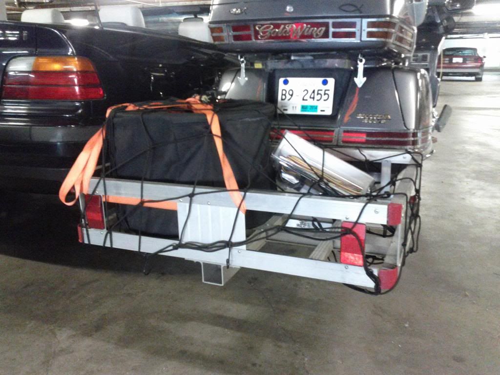

If you have a receiver hitch, get one of these racks and load it to your heights joy.
It seems like I got mine from JC Whitney or J&P Cycles in Anamosa, IA.
I might also add Gold Wing World.
Found the one I was looking for.
http://www.chromeworld.com/ProductDetails/ProductDetails.aspx?pid={a1a402a0-07a5-43d0-b156-9948789ae65b}&pname=Rivco+Trailer+Cooler+Rack+18X30&Referer=QUICK_SEARCH&Alias=luggage rack&ptct=BS-SR&CTitle=&
gordonv
Posts: 5766
VRCC # 31419
Richmond BC
« Reply #4 on: July 01, 2013, 10:20:19 PM »
I believe the trunk says 20 lbs max, this would be the total weight, and that it wasn't realy designed for external weight.
But like RJ mentioned (I didn't look at it) get a cargo carrier, and mount it in the trailer tongue mount. I bought the aluminum cargo carrier from HF (sames one in Princess Auto), for a car. Used a carbid blade on a skill saw, and cut it to the same width as my Goldwing. Drilled out the pop rivets, and rebuilt it.
One caution. I'm sure the carrier will carry a lot of weight, but remember that the tongue weight of a pulled trailer would be a lot less. I don't have one, but I think people have mentioned something like 35-50 lbs.

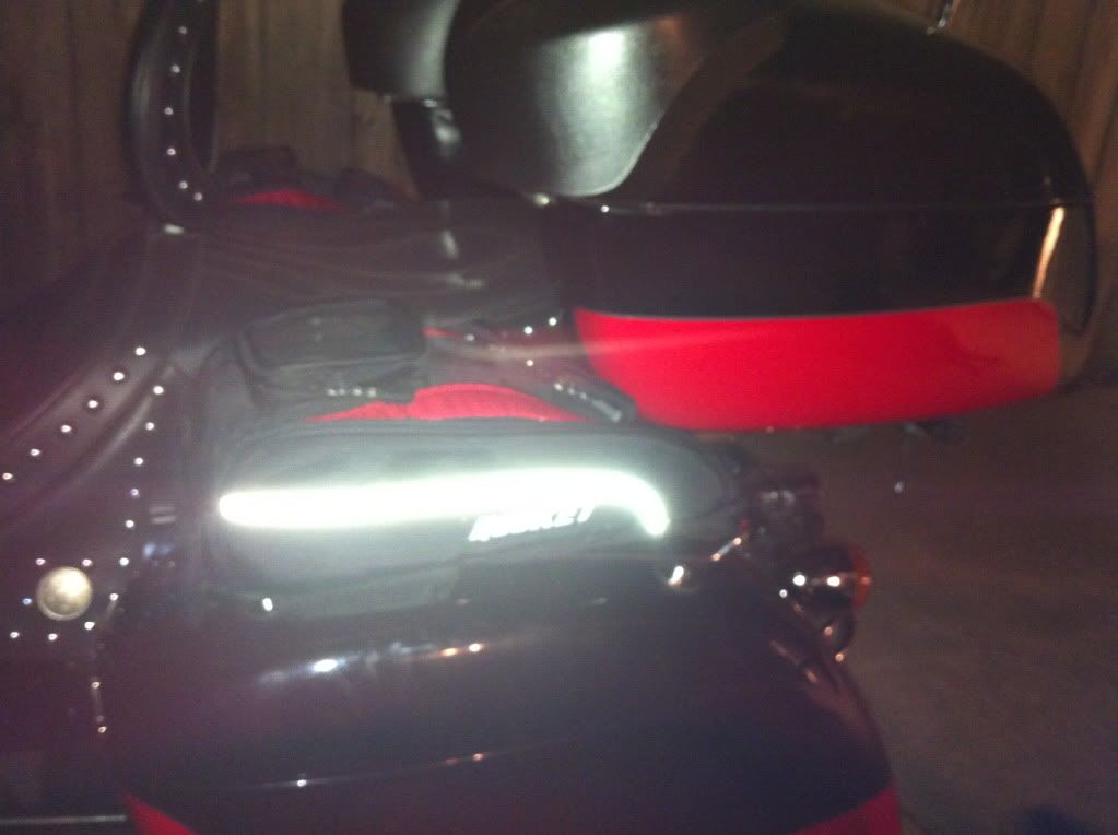

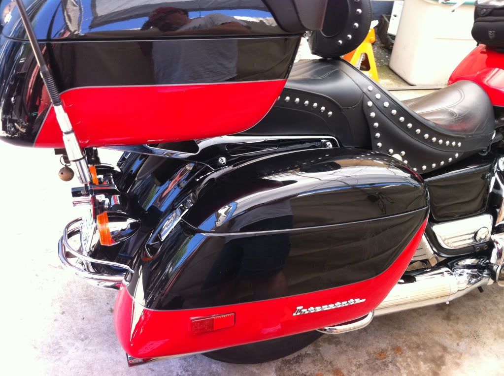

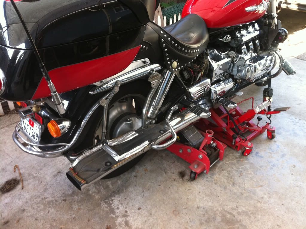

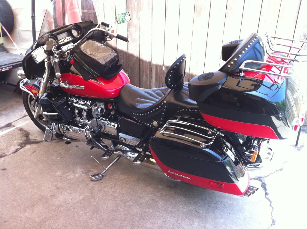

I have the same one, picked it and the rack and all hardware up a couple years ago (gave $99 shipped from Goldwing country I think) when I went to Vegas and we probably loaded it over what I should have but I would guess it was better part of 30lbs. No issues at all. I also added saddle bag racks and some small tank bags to each saddle bag rack we packed for a 5-6 day trip and never needed anything else, we over packed a bit...
Before,
After,
Before,
After,
And of course all loaded up, less the tank bags on the saddle bags.

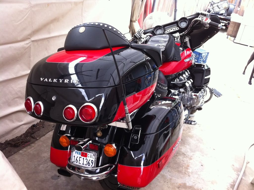

Im just curious where you got the black anttena next to the rear trunk?
Thank you,
Bryan
fordmano
Posts: 1457
San Jose, CA.
« Reply #10 on: July 03, 2013, 11:04:21 PM »
If your asking me. Roll Eyes Cheesy Grin
I modified a regular auto replacement one from kragen/o'reilys.
Had to permanently modify the original base of the stock antenna and some hand grinding to make it fit using the original threaded insert of the stock antenna.
It seems like I had to actually take a hardened long threaded bolt and made an adapter to go inside the actual mount... Sorry it's been a long time since I did it.
If it's any help here are a couple of pictures that are a bit easier to see.
I figured if you could see the parts that look familiar it would help you figure out how to start making your own if your so inclined to do...
