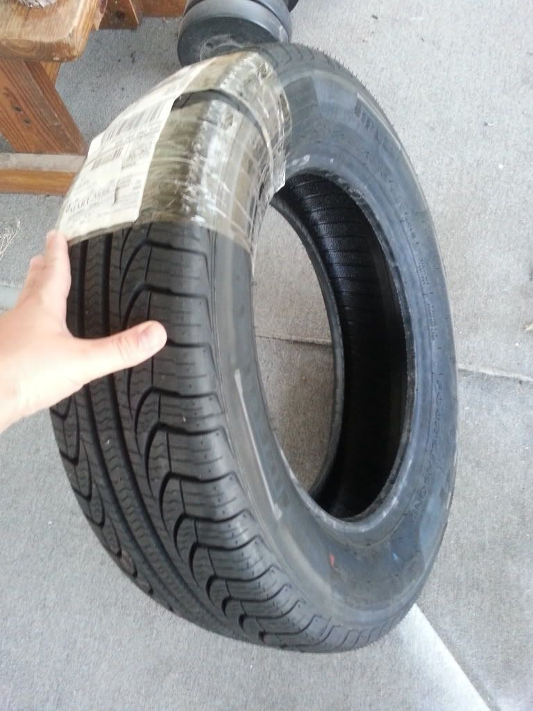

Additionally, I decided to go back DS with a Pirelli P4 205/65/16
So when the defective Shinko comes off.....the CT is going on. And I'll have a spare "hopefully round" shinko on the shelf. Beware of the shinkos. My lesson is learned.
