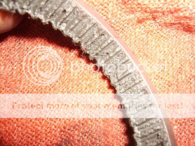

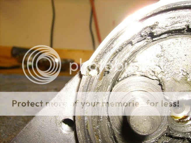

I reached in through the starter hole with my finger and spun the gears all the way around and they spun smoothly with no evidence of any damage that I could see.  The splines on the end of the starter look good as well.  Maybe it wasn't a hydrolock that broke the starter.
The dowel pin that is supposed to hold the ring gear in place was completely missing and I don't know how that could have happened without someone taking the starter apart.  The case is only slightly deformed, not busted up enough for the pin to have gotten out.  The grease in the reduction gear case was pretty much solidified so maybe the gears just failed due to lack of lubrication and someone took the starter apart to try and fix it but didn't get it back together right.  They certainly did not replace the bad parts.  I'll try to take some pics and see if I can figure out how to post them.

Here's a shot of my gears.  I've spun them all around and they all look good.
Here is the reduction gear housing where the dowel pin was supposed to be.
Here's another starter part that did not stay in place
And here is the ring gear.  I'm not sure you can tell how badly damaged the teeth are but they are very bad.
