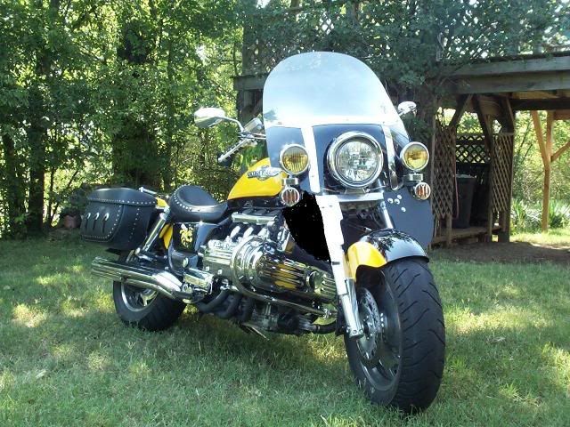

« Reply #8 on: August 25, 2013, 08:46:46 AM »
Well, they ended up painted..  Here is what I ended up with.....  I think maybe different hardware and gloss black on the front if they work......   I going to try them out     see if I can wear a sombrero

« Reply #10 on: August 25, 2013, 02:24:50 PM »
Those are sharp!  Way better than my show chrome lowers, and I bet you don't have to coax those clamps on with a dead blow hammer.
I wonder if you put them on too high,, or maybe turned over......  the tubes are tapered in that area,,, about 20 thou per inch.
These lowers seem to work perfectly, nothing distracting about them at all other than their appearance,,,,  no harmonic vibration,, no wind noise, nothing... it's more like there was a piece missing and I put it on.  It certainly did cut down the breeze substantially,, but like everything it is marginal... don't think I'll be reading the paper while cruising,, but I should be able to keep a hat on.    Now....   to find the perfect hat.

« Reply #16 on: August 27, 2013, 10:23:26 AM »
Like this???
I'll have to look at it for awhile,,, I need to paint the front of the other one gloss black or put a clear coat on it and see what it looks like.
