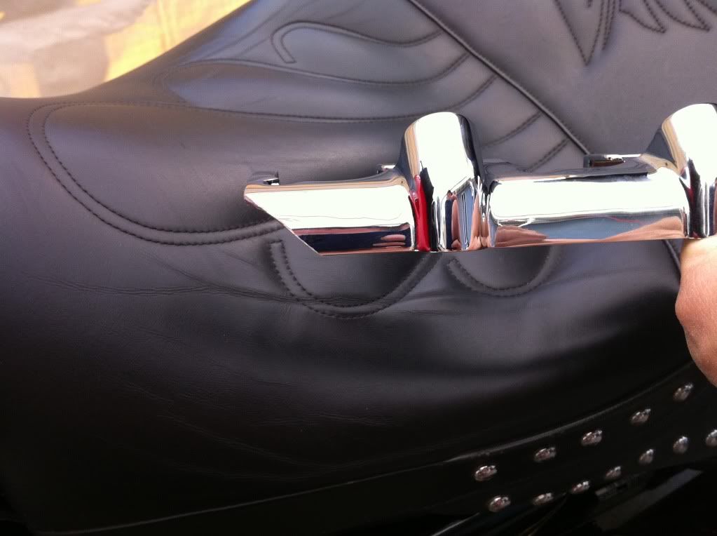

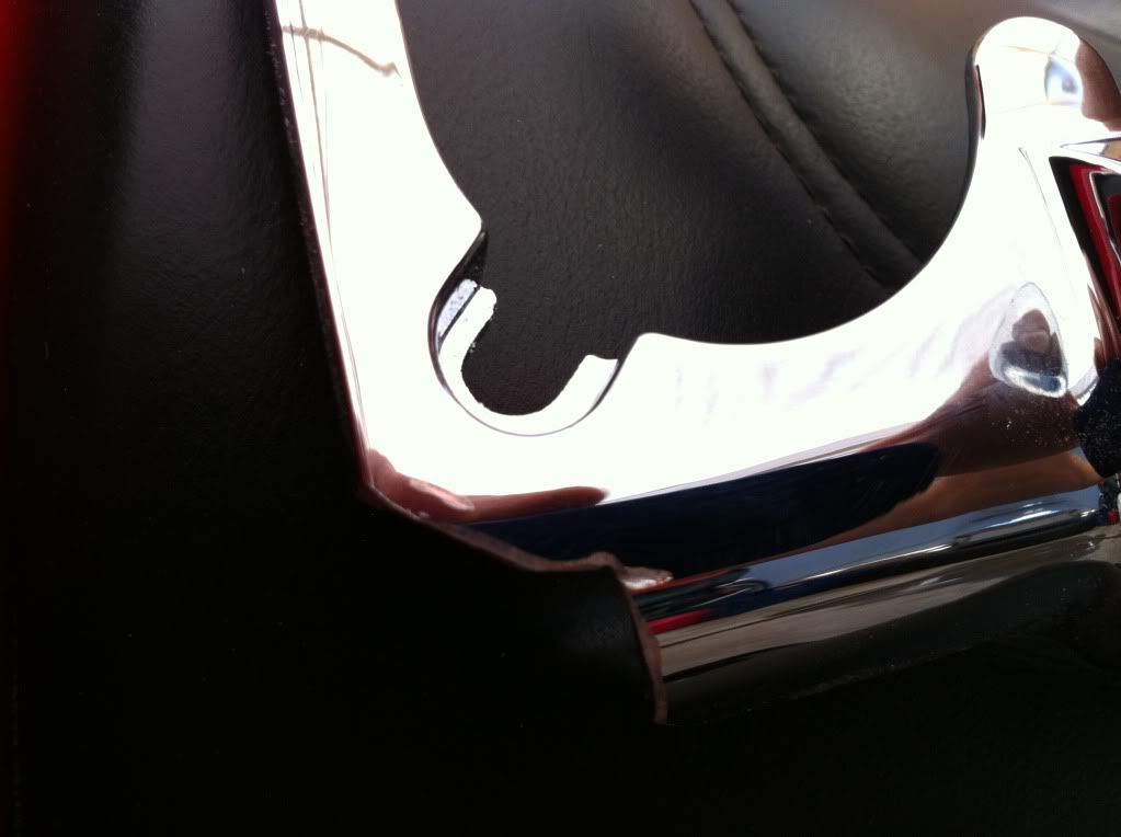

Has anyone installed the Shiny Desmog kit with the Kury plug valances?
If so, any issues?  Mark and I just received our shiny demogs and will be installing in a few weeks.
Just wondering if there any pitfalls to watch for?  I am impressed by the quality and completeness of Redeye's shiny desmog kit!  Very nice kit!

I have done 3 now and no real issues. Works well but it does take a few extra minutes and a moment of scratching your head to figure out how to get your fingers under the covers to hold 2 of the plug hold down thingy's.
It gets even tougher when your installing on an I/S and have the covers for a Standard/Tourer, a dremel is your friend when installing like I did.

I just use a small piece of clear scotch tape to hold the plug thing in place under the runner start all the other screws a few turns then push the screw and puncture the tape and turn the screw with a t handle allen head tool all in 1 motion  it dosent give it a chance to pop out of place the tape drys up and flakes off in time or use  needle nose to pick it out
