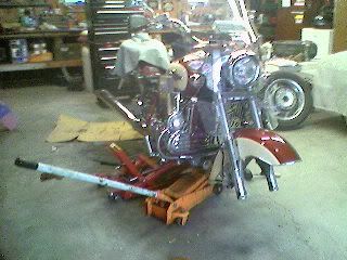

I did'nt see any remarks in of Denny's post that would cause me to get upset, but have a fairly thick skin. I usually use a smiley to indicate my lack of malice, or, infrequently, my displeasure.  And tips on search function is a good thing.  And a location can bring someone to your door to help out. as you see from the pic, I have a tendency to get over my head once in a while.  Hoser  cooldude
