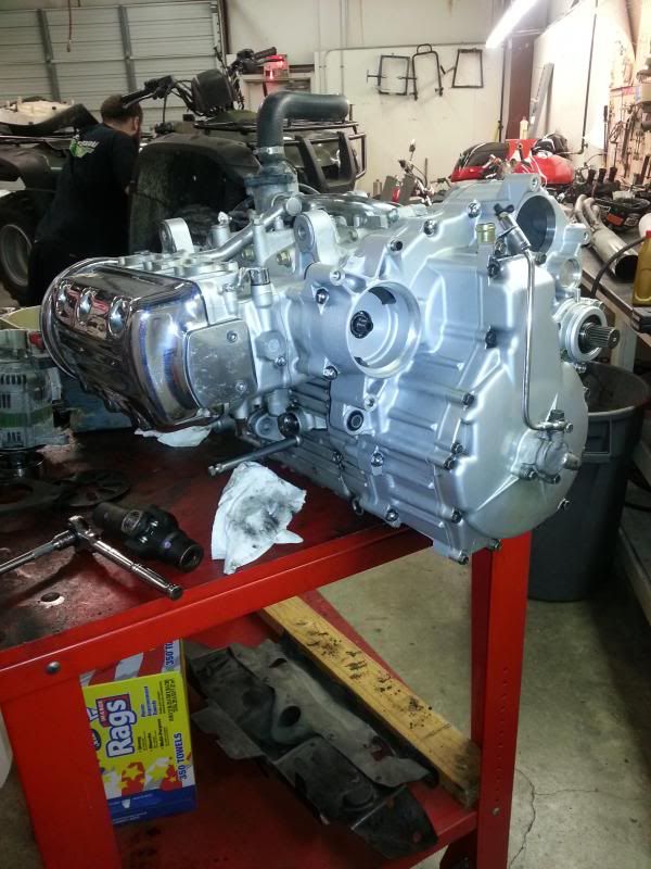

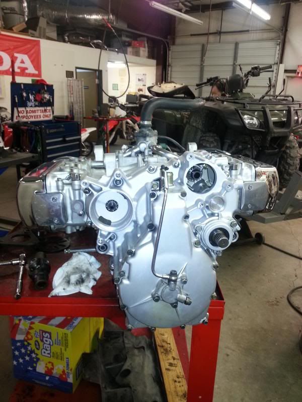

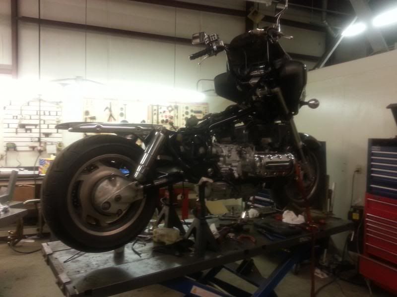

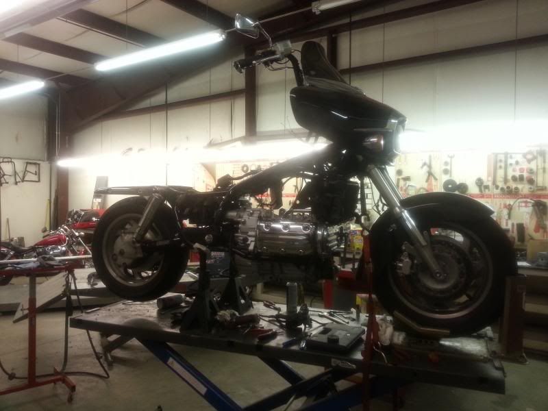

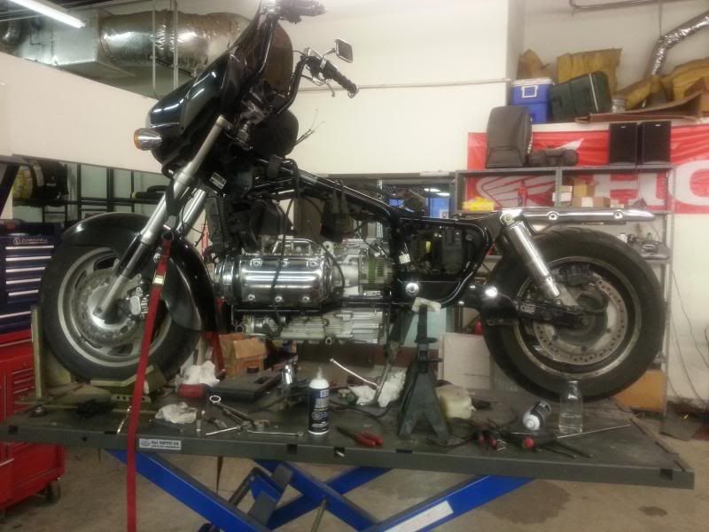

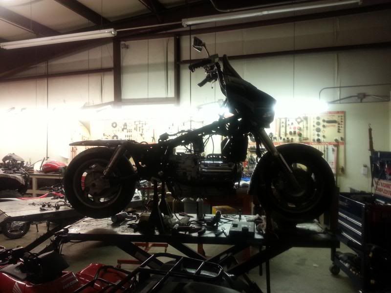

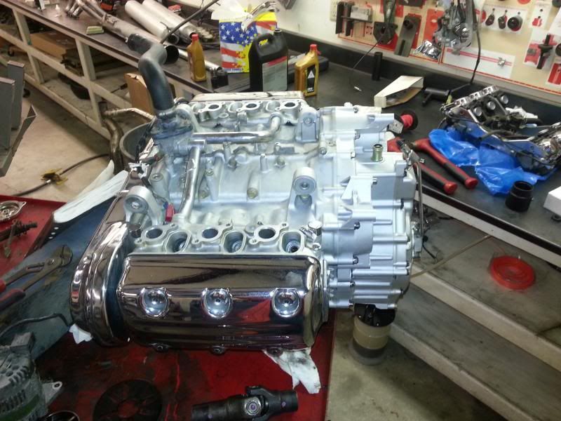

« Reply #43 on: January 10, 2014, 08:12:10 PM »
Lots of pics.  The damage was limited to the starter gear, the gear in between the starter gear, the idler gear, the pin that the little (intermediate?) gear rides on and the rear case itself.  The bike now has a pingle valve on it as well as new float valves.  While I was in there I desmogged the motor as well...

« Reply #44 on: January 11, 2014, 07:19:41 AM »
Any pics of the actual damage?
F6BANGER
Posts: 835
Albuquerque NM
« Reply #45 on: January 11, 2014, 08:38:24 AM »
Look at Reply #26 on this thread
pouch
Posts: 38
« Reply #46 on: January 12, 2014, 06:57:04 AM »
destroyed small gear and metal shaft to rear housing. dan marc was added then this never happened again. these are carb issues and can destroy a lot of stuff. pouch
Posts: 13846
« Reply #47 on: January 12, 2014, 11:02:12 AM »
Nice job on cleaning the engine...Looks like new  cooldude
