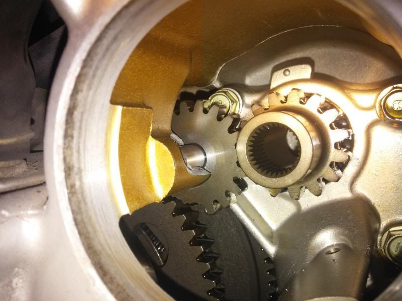

« Reply #26 on: December 13, 2013, 08:29:07 PM »

« Reply #27 on: December 14, 2013, 03:54:06 AM »
Update ... for sure the motor is coming out and is in fact ready to drop as I type this.  The I guess "typical" damage of the gears and the rear case cover.  Yippee parts on the way...
Is dat part of the case itself,,,,,,,,,,,,,, that's broken on the left side,,, of da pic?    coolsmiley

« Reply #29 on: December 14, 2013, 05:50:37 AM »
Yes the case and gear...
« Reply #30 on: December 14, 2013, 07:04:47 AM »
That pic pretty much shows what happens when the cylinder locks and the button keeps being pushed. ' Tap' that button.

« Reply #31 on: December 14, 2013, 08:18:47 AM »
I can't tell from the picture if any teeth are missing on the gear to the right. If you didn't do it already, you might want to order that smaller gear to the right....the one the starter goes in. Even if no teeth are broken, at this point some have been hammered and strained and thus are weakened. Years of experience speaking.  cooldude

« Reply #35 on: December 16, 2013, 12:12:41 AM »
Hey that looks familiar... I did the repairs to a guys bike a few years ago... Not too difficult just time..
