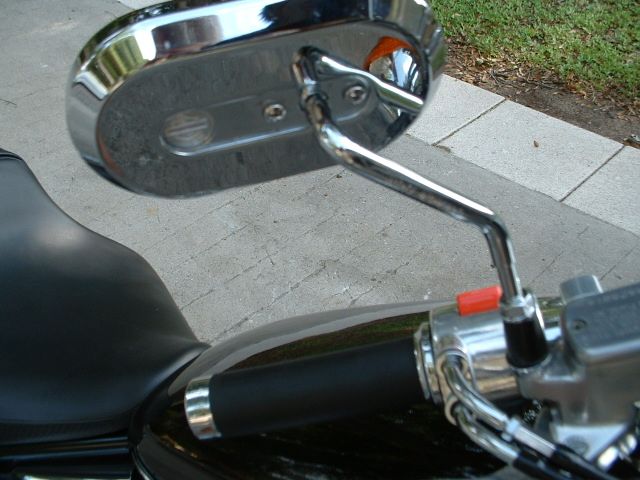

I put Harley V-Rod mirrors on Kim's Shadow years ago but I had to make the adapters.
The HD mirrors had 5/16-24 thread & of course Hondas have 10mm.
Bought two 10mm bolts that fit the Honda mounts, took 2 each side 5/16-24 thread nuts {just happened to be 289 Ford rod nuts that I had in my stash} & welded them stacked on the top of the head of the 10mm bolts to make a female thread connection for the V-Rod mirrors. Looked pretty ugly as it was so I used JB Weld Kwik as "bondo" to hide the welding in a barrel shape. Sanded the JB Weld down to a smooth finish & painted it black.
Used a plastic washer under both the 10mm bolt & the 5/16 jam nut of the HD mirrors to minimize vibration. Worked great for years until Bro-in-law wrecked the Shadow.
BTW, the V-Rod mirrors started rusting about 2 years after installed.  Roll Eyes
Double BTW.... The V-Rod mirrors were free & much better looking than the Shadow "lollipop" style.  Wink
