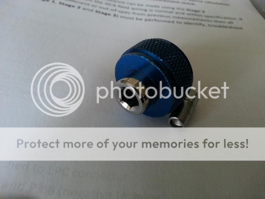

I can't compare RedEye's D tool to this but this is what I have and so far so good. It's a Craftsman 41380 knurled holder that accepts the a hex D shaped bit from MotionPro. The hex D bit is made of tool steel rather than brass so it's quite tough and holds up well. It just barely fits underneath our carburetors on the bike but it does fit so you can make adjustments with the bike running if you want.
One end of the Craftsman 41380 holds the hex bit and the other end accepts a 3/8" wrench. I've been lucky enough to never need to use a wrench and simply use the knurled cylinder with my fingers.

Here's one more pic and a link to the MotinPro D-Shaped bit on Amazon.

Thanks!
Looks much sturdier than the one I have.
