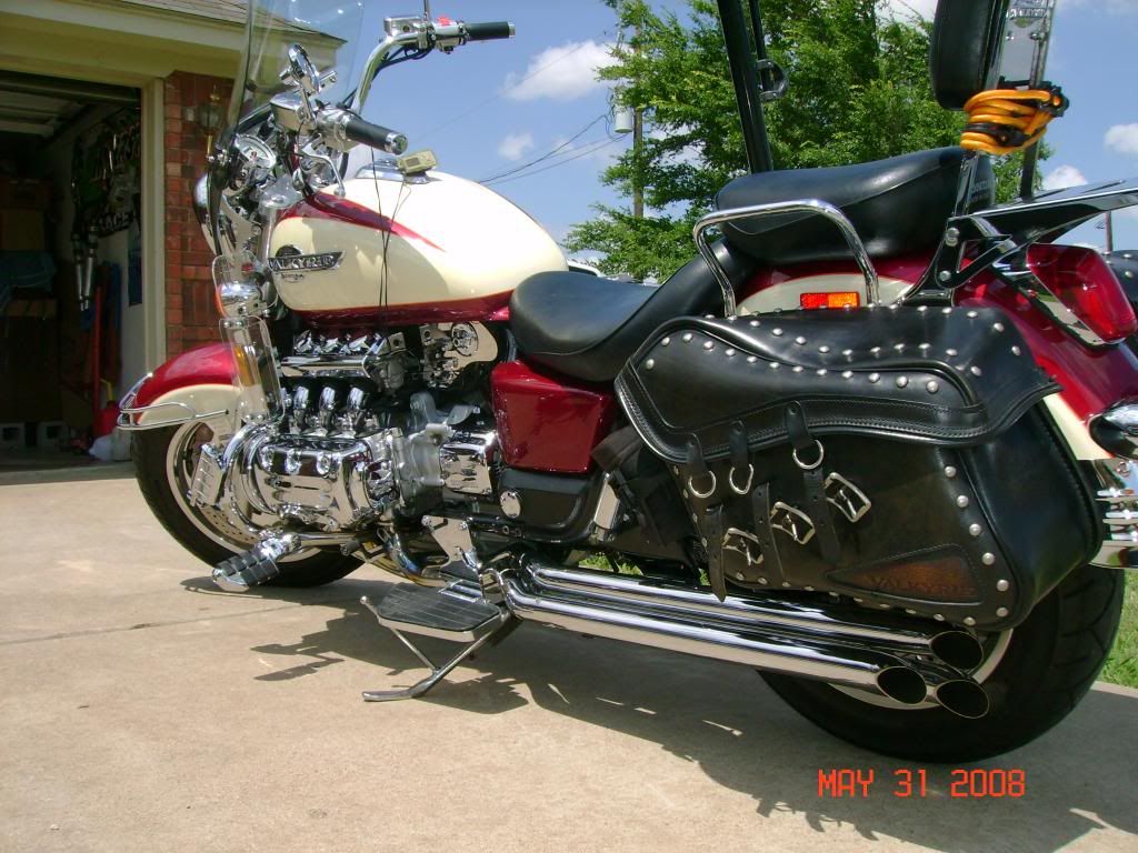

I wouldn't ride without them now, first 98 standard, I installed  some used MC , they got sold with the bike, and now have corbras on my 01  , the MC's were much more beefy in my opinion. The cobras are flaking and pivot points are loose. personally I  would try to find some MC's. If I remember, I think they were aluminum, and I could polish them up (around the edges) nice. But I also think I was wrong , once.   cooldude

*But when considering boards, you have to be aware that depending on foot size, and if not using a (now discontinued but probably still available used) Rattlebars peg lowering kit (which I think Westsider has in the pic of his bike with MCE boards),  installing driver boards can lead to difficulty getting your toe on the shifter (and many end up moving it one tooth on its spline mount, up or down).   And some others have  replaced the valk shift arm entirely with a longer one off another model honda (CBX something, sportbike?).  This problem is also solved with a heel toe shifter which I think most guys with boards use (me too, and with no peg lowering kit).  But no heel toe shifter is availble anymore new, except as part of the MCE kit.  Otherwise it's back to used Rattlebars or Kuryakyn.  On the other side, there is no issue with the brake at all.
