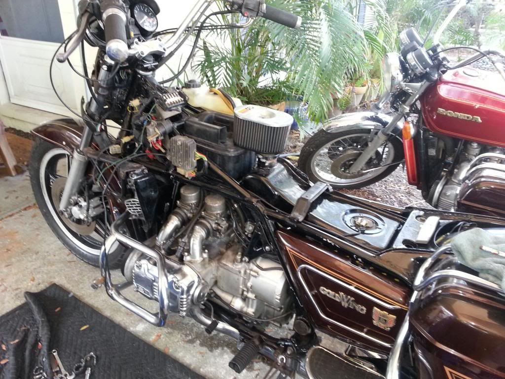

« Reply #3 on: February 06, 2014, 05:32:14 PM »
Various pics from the past few days.

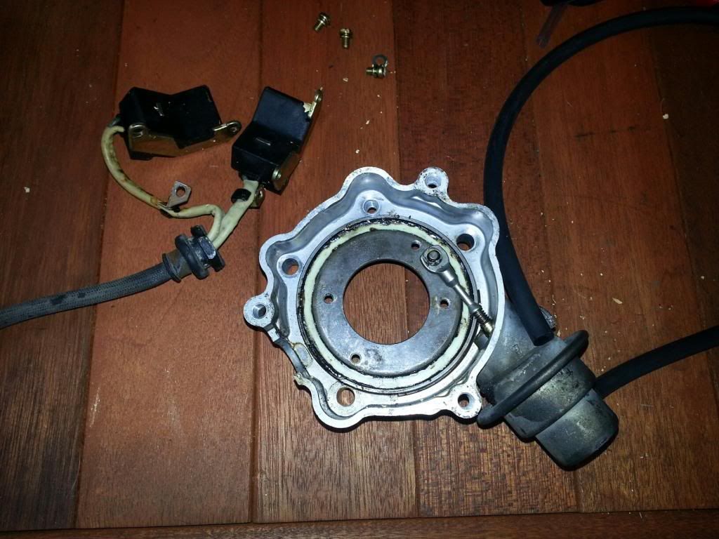

I would really like to get it running properly before tearing everything down.  I think I'm going to try and replace the vacuum advance before pulling the engine.  Reason being I want to know condition of clutch, tranny, engine and final drive so I don't have to pull engine twice should there be a problem.
Here's the one off the other engine that came with the purchase deal.

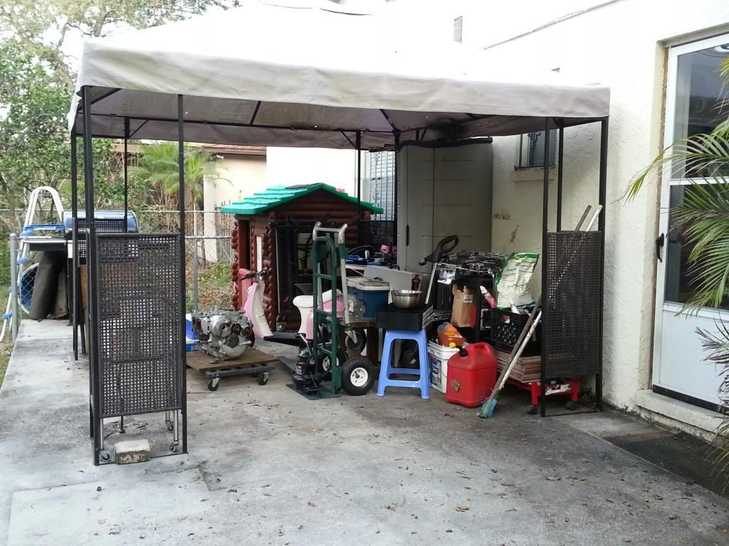

« Reply #9 on: February 07, 2014, 06:26:45 PM »
Here's a pic of my fully equipped "shade tree" shop! LoL  Think I should move it to the back yard near my little machine shop.  Sold the BMW to make room for the Goldwings and Valkyrie.

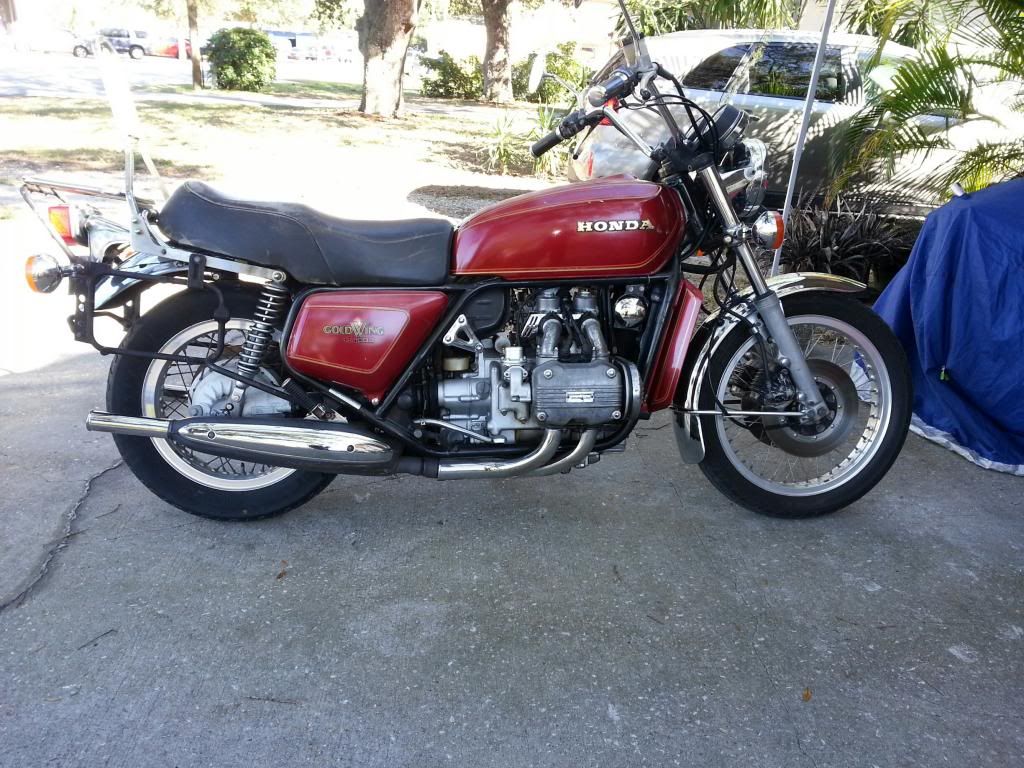

Look what else I found behind the "log cabin dog house" when cleaning up. This will definitely come in handy. Might be the best $20 yard sale item I bought about two years ago. (Never used it yet and needs a bottle jack. Harbor Freight here I come! LoL)
'77 Gold Wing, '81 Gold Wing,

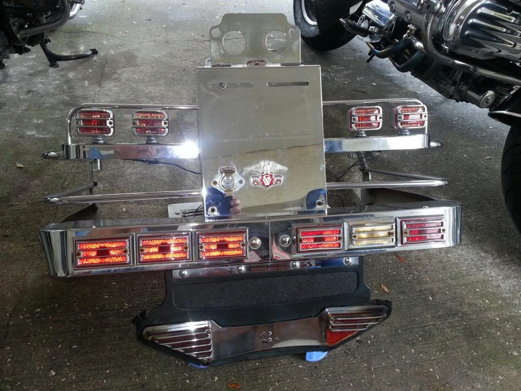

Just had a wake up call about "what I believe is a bad business!" Took my timing belt covers to a Chrome refinisher, here in Tampa, and the guy told me it would cost about $500 to re-chrome one set of covers. I said thank you very much and left. I just bought a brand new set for $58 with no exchange and free shipping!
Just got my new timing valve and it's really nice.  The picture doesn't do it justice.  I just ordered another for the '77 GW I bought.

« Reply #27 on: February 20, 2014, 04:26:49 AM »
Wish I could finish up the '77 GW so I can go to work on the '80 Gw.  Been trying to find an elusive clunk somewhere in the drive line.  Yesterday I put on another final drive and still has same clunk.  Splines on FD and coupler are in good condition.  Going after the output shaft dampener next as suspect but I have a nagging ferar, in the back of my mind, it may be a clutch dampener plate in the middle of the clutch pack.  When I get this clunk gone it will be on the back burner for restoration then I will put my efforts into the '80 GW.  With all this maintenance going on I think my Valk is getting lonely for a ride!  LoL
« Last Edit: February 20, 2014, 05:32:25 AM by RonHolly » Logged
OnaWingandaPrayer
Posts: 621
« Reply #28 on: February 20, 2014, 03:32:17 PM »

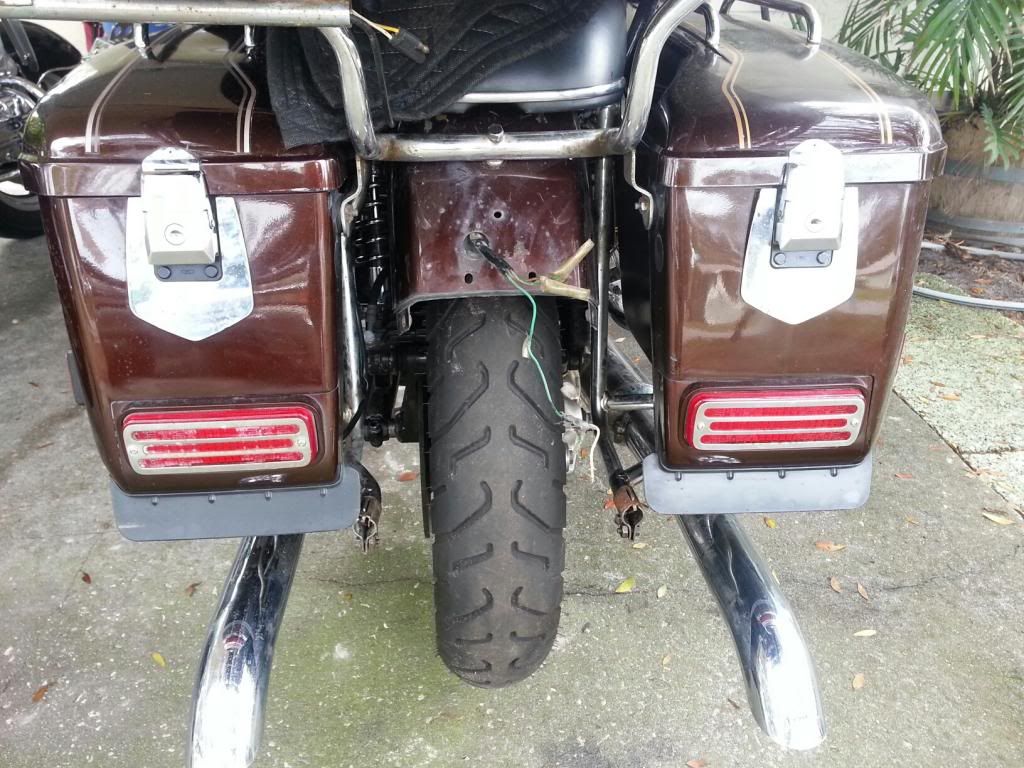

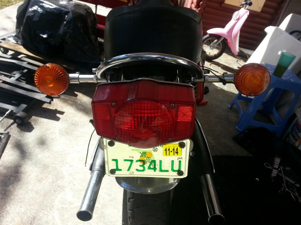

 Hey Ron that 77 looks quite nice . Do you have the detachable bags ? I see brackets .I think you may have an addiction  cooldude
RonHolly
Posts: 277
USAF Ret. '68-'92
Tampa, Florida
« Reply #29 on: February 20, 2014, 04:49:19 PM »
No bags came with it and today I took off the mount for them and installed rear turn signal lights.  Had to make attachment bolts so I could use the stock seat hand rail.  Drilled hole in longer 2" bolts for wires and milled slot in tube so they wouldn't slip and turn.
« Last Edit: February 20, 2014, 04:55:32 PM by RonHolly » Logged

Almost finished with the '77's mechanical/electrical issues.  Won't start painting till later though.  She really runs good except of the "clunk," which I think is the final output dampener.  It's tolerable until I pull the engine and start the painting and polishing of everything.  Went by a powder coating place and said he would sand blast and powder coat it for $220.  Don't know if that's a good price or not.
