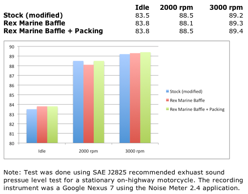

Hey Mr Bill -  We seem to have the same exhaust sound concern.  I just picked up a 2000 Valkyrie with stock exhaust that has been modified and is very loud.  Sounds cool, but my ears can't take it.
I purchased the rex marine baffle and ran some sound pressure tests to see how much of a difference it would make.  I used the SAE J2825 motorcycle sound test procedure to try and quantify the sound change.
How to Perform a SAE J2825 Motorcycle Sound Testpowered by Aeva
Surprisingly, in my test the baffle didn't make any significant sound pressure change.  I didn't hear much of a difference in sound quality either.  I did try putting in 1" of muffler packing in the baffle and that did change the timbre slightly.  Made it sound a little less harsh but didn't change the sound pressure level.  I even tried putting some steel wool in the baffle.  Don't recommend that.  It sounded choked off and still didn't change the sound pressure levels.
One thing I would like to try is moving the baffle to different locations in the pipe (I had it 3" from the end).  Possibly there is a 'sweet spot' that catches the sound wave at the right location to affect the sound pressure level?
If anyone has any suggestions on a way to quiet a modified stock exhaust system down, please let me know!

Here are some videos and results of the test:
2000 Honda Valkyrie modified stock exhaust sound pressure test (part 1/3)powered by Aeva
2000 Honda Valkyrie modified stock exhaust w/Rex Marine baffle (part 2/3)powered by Aeva
2000 Honda Valkyrie modified stock exhaust w/Rex Marine baffle + packing (part 3/3)powered by Aeva

Hey Scott, did the Rex Marine baffle reduce the highway drone?  I've been considering getting a pair for my IS that had the piggies cut.
"A Camera And A Bike....What More Do I Need?
schid
Posts: 2
« Reply #10 on: March 20, 2014, 01:18:15 PM »
I haven't mounted the baffles on the bike permanently yet.  They were just slipped on for the sound test.  I'll report back when I can test them on the road.
