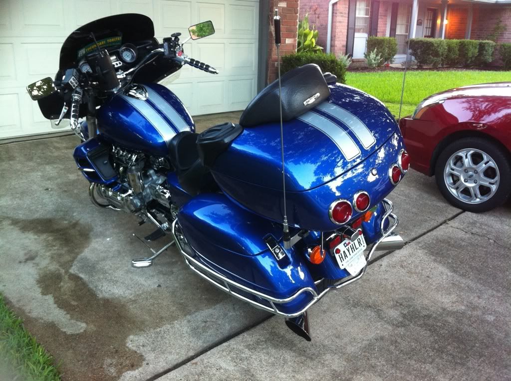

I bought the bike Dec 22 and I am Valk noobie. As I was looking it over I saw this and wasn't sure how concern I should be about it. It's a plastic ring? that is on the right-side of the rear wheel. There's a small piece that kinda pull away from the ring. Any help\ideas would be appreciated.

That in itself should not be a problem.  Looks like someone drug in on concrete or similar.  That part might be cause for concern.  It is just a plastic ring as you said.

Plastic is not the problem, but what is coming out and hanging could be. Could be metal shavings from the flange . I would pull the wheel , inspect and service ! It should be done every 10 to 15 K anyway!       uglystupid2

Are those cobwebs??
pancho
Posts: 2118
Bonanza Arkansas
« Reply #5 on: April 16, 2014, 04:55:24 PM »
Are those cobwebs??
That's what it looks like to me.     You really should pull the wheel anyhow and do an inspection and the maintenance anyhow.  THat area can be a problem in not serviced correctly. TIme to check the flange, splines, pinion cup and dampers.  There are some areas of this bike that you will need to learn to service if you expect to keep it for awhile and want it to be troublefree. THe first thing you need is a service manual... I will see if I can find the link to the downloadable one on the Norway site.....  You will love this bike.
Here is the link to the downloadable manual........ http://www.valkyrienorway.com/download.html     Dag did a good thing getting that scanned and available to us.

Follow the info from the board. The Clymer manuals are guidelines. The tech on here is the voice of experience. See if there is someone near you if you are unsure about doing the service. I just showed a brother how to service and tire change his Valk. Also A L S O  do not use the oem valve stems. If you have them , change them while doing the service. You do not have to dis-mount the tire. The rear tire will be off , so it will be easy.

I'm thinking steel wool from someone trying to clean the rims. I would still pull the tire and inspect/lube the final drive. When I got mine, she had 32k and lube had never been done based on condition of grease and u-joint Angry

Dust bunny?

You bet ucjb,,,, yes there are some other other areas that will need attention, but one thing at a time, you will hear all about it if you visit this board. That rear drive, splines and pinion cup are probably the most critical inspection/maintenance need at the mileage on the bike,,,  and valve stem replacement as was mentioned.
Look at the bottom of the intake tubes to see if there is any brown staining oozing from the area,,, the orings are due for replacement as are vacuum hoses and rubber nipples on the intakes.

Looks like a dingle-berry ...don't eat it !

Using your buddy mechanic is ok, only if you tell him this little tidbit of advice.
"While reassembling the rear end and torquing the axle nut, make dang sure that the 4 nuts on the swing arm are loosened (finger tight)."
This allows the splines, bearings, and other parts to align correctly.  AFTER the axle nut is torqued, the 4 nuts on the swing arm can be tightened.
If he, and you at a later date, follow this advice, you will have many more trouble free miles from the rear end on the Valk.
