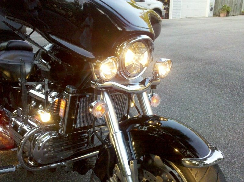

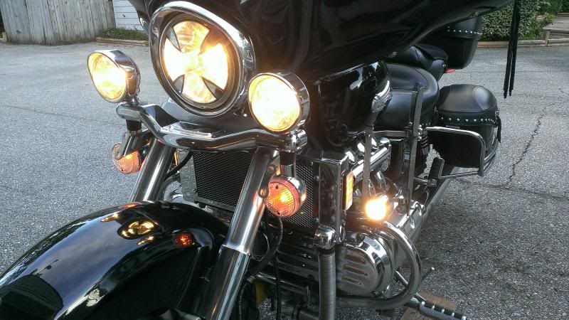

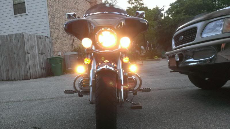

Going for floods or fogs to light up the sides of the roads better in the evenings when I ride. Lots of forest rats up this way....should have been more clear on the light spread. Reason for doing it before Inzane is that I will be running power up forward anyway before I go so I want to do it all at once. Bought a Denali power center  to handle the systems.
« Reply #7 on: April 28, 2014, 05:51:00 PM »
Pappy, I see no negatives with adding lights to your engine's guards.
I got them here....
http://www.bigbikeparts.com/Inventory/Navision/16-104A?catalogNo=1
Trust me when I say they light up the road and the sides of the road very well.
I ride/commute a lot at night.....I've got way more than plenty of light to brighten up the night.  If you don't have a lightbar on your bike, I highly recommend adding one of those as well.  The crash bar lights (they're 50wt) cast a wide and bright path and I very highly recommend them.
Another big plus IMHO is that not only do they light up the road, but they also light up the front of your bike....especially from the sides.  You're wheel and fender are lit up for everyone that approaches you from the sides.  If you have a two tone factory paint with some white on the fender, they really highlight the front of your bike.
You can't have too many lights on a motorcycle.  Not just for you to see, but for everyone else to see you.

Thanks, BF! I should have remembered you had them on your bike. Knew I had seen them on one around here! Will proceed now that I know the glare is not an issue there. Would have had to order a different mounting system otherwise.
