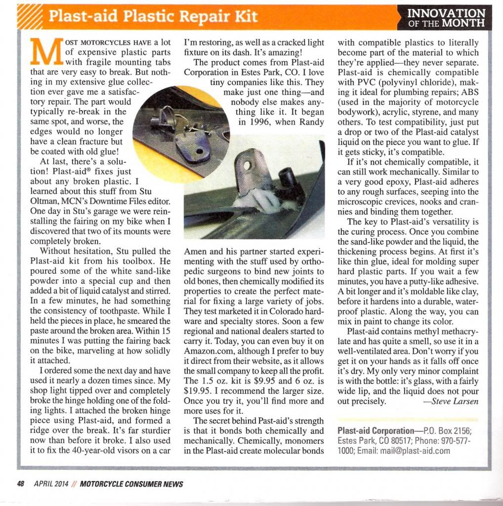

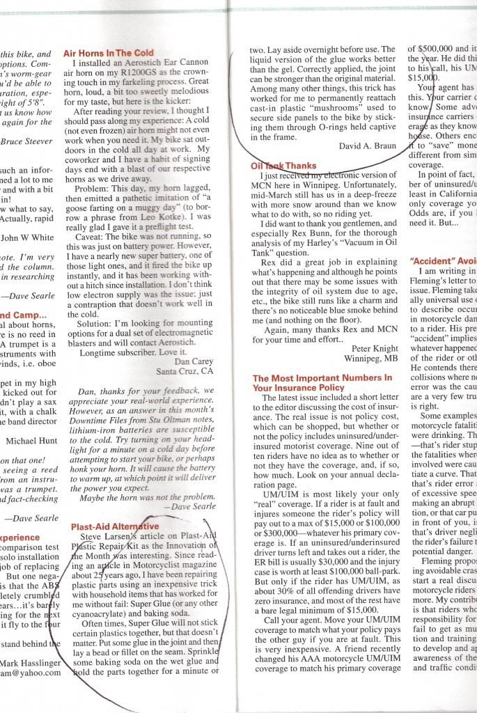

Motorcycle Consumer News just reviewed this in last month's issue.  Below that is a response from a reader.  I haven't tried either, but looks promising.

Plast Aid looks like the perfect product for repairing my fairing. One of the metal gromets has busted loose and the plastic around it is all busted up. Just ordered some and will let you know how it works. Perfect timing. I was going to go look for ideas on how to fix this tomorrow. Thanks for sharing this information Jet Driver.   cooldude

When using Plast-Aid, do it outdoors.  Lots of nasty fumes. crazy2

« Reply #14 on: May 01, 2014, 08:36:49 AM »
Google some customer responses (I think there's some on Amazon).  Looks like there's a learning curve to this stuff.
