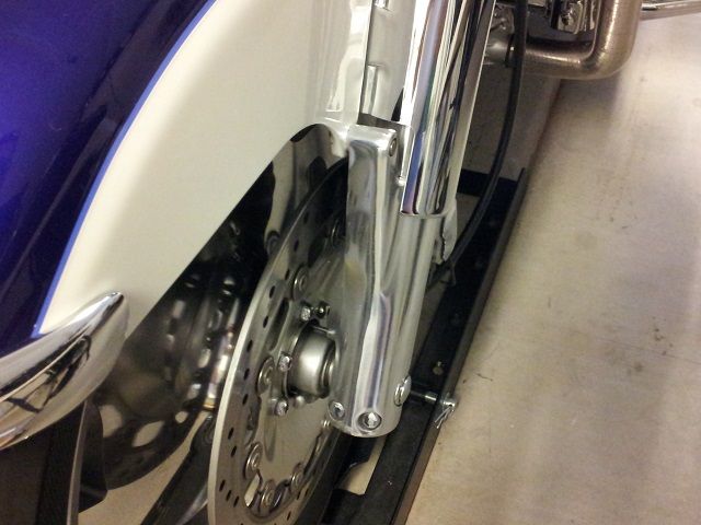

I wouldn't blame it on Florida. Aluminum and 16 year old aluminum need to be maintained regardless. The Florida Valkyries I've seen are spotless and there's quite a few of them. They are all well ridden high mileage Valkyries. It just takes a little elbow grease. I wet sanded mine, buffed and final polish/shine with White Diamonds. I hit them once a year with White Diamond and a rag by hand to keep them looking like new...This wheel was installed last year due to a damaged wheel and slipping race on mine, and it looked like yours when I got it.
