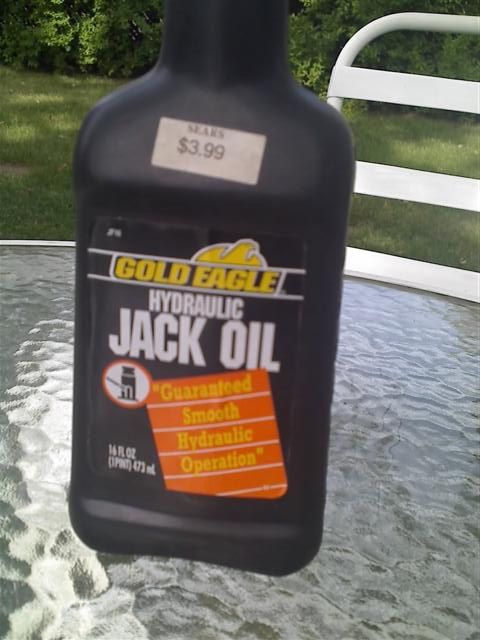

« Reply #7 on: May 19, 2014, 05:58:03 AM »
Yes, you're supposed to change the fluid in the bottle jack once a year.
With this....
