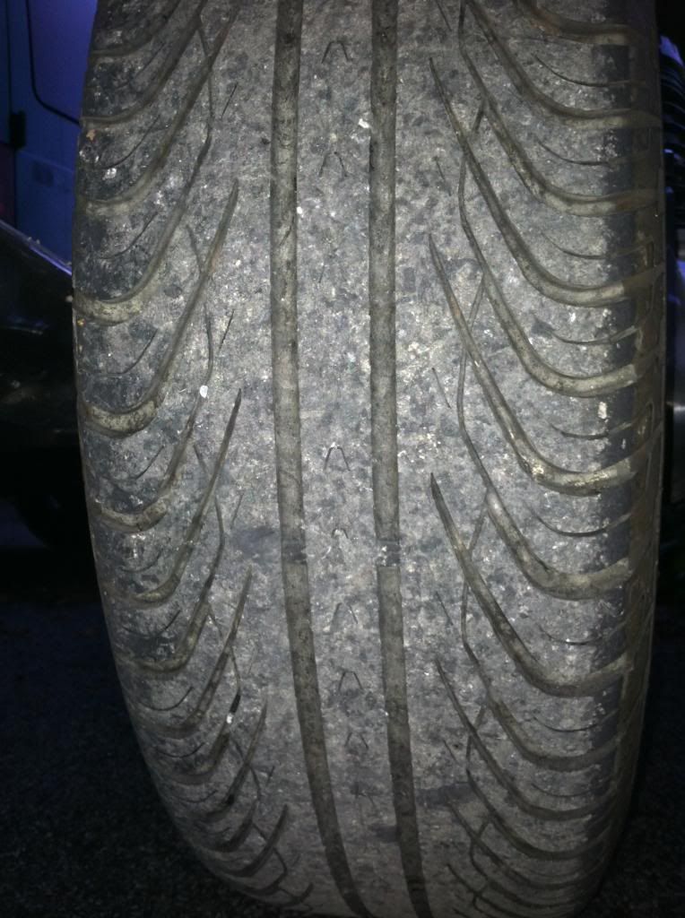

« Reply #22 on: June 24, 2014, 07:53:44 PM »
Not the best photo--it was after dark with a flash--but still shows lots of wear left after 25K miles.  I will confess a preference for General Tires, I have them on my Lebaron, Astro Van, and the Saturn I recently gave to my nephew.  Photo is a General Altimax HP on my 2001 Standard.

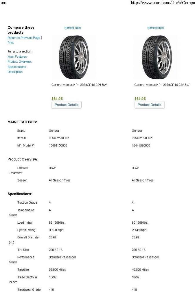

Yes, it looks like the Altimax HP is discontinued.  Bought a 205/60R16 H speed rated today for $70 out the door.  Had a date code of 4912--almost 2 years old.  I should be good for another 5 years or so.
QUESTION: Are those of you who are getting less than 20,000 miles on the Altimax running the H speed rated or V speed rated?  I noticed the V speed rated has a significantly lower mileage warranty.  The one I got over 25,000 miles was H speed rated.

« Reply #32 on: July 26, 2014, 11:07:41 AM »
Mine is V rated. I think they have the same tire wear rating, though (440 if I remember correctly) . So I would think the tires would have the same tread life, but I'm not a tire expert.

« Reply #34 on: July 28, 2014, 07:57:42 AM »
I'm no tire expert either, and I have no explanation for this.  Although both tires have the same treadwear rating of 440, the H speed tire lists a treadlife of 55,000 miles, while the V speed tire lists a treadlife of only 40,000.  Here is a comparison from Sears:
