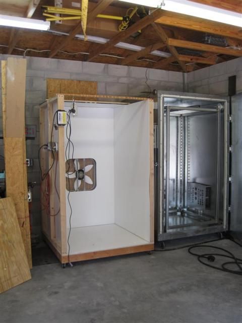

I'm talking about the stripes on the valve and timing belt covers on your old Wing. I've polished up those covers but would like to add some color soon as I figure out the basic color I'm going to paint the tank, fenders, side covers, etc. Might even look at doing the intake runners but need to finish building my single carb intake manifold first.
Just wondering if it's something I can do with a small oven similar to what we have on the kitchen counter. Or is that too close and concentrated a heat source? Valve & timing covers wouldn't fit in there anyway, but the intakes would.
Jeff K
Posts: 3071
« Reply #1 on: June 26, 2014, 05:45:24 AM »
I have never used a toaster oven but lots of people do. Mosa did a bunch of MG parts in a toaster oven and they turned out great.
I just found a cheap/free oven on CL and used it, till I built my big oven.
Its all pretty easy. Just make sure you like it before it goes in the oven, it blows off easy before you bake, after you bake it is a job to remove it.

Yeah I went a bit over board on mine. the powder boot is handy.

Can you get a set of OEM pipes in there? I have two stock sets with some surface rust and was thinking of having the headers done with something similar to Ceramachrome(see link). I'd have to remove the muffler cover and the short end piece, plus the lower header cover where they come together. The heat shouldn't damage the naked muffler or existing pipes.
http://performancekote.com/motorcycle-coatings.html
Jeff K
Posts: 3071
« Reply #6 on: June 26, 2014, 08:08:18 PM »
Easily. I was going to do some ceramic coating, that stuff is expensive.
