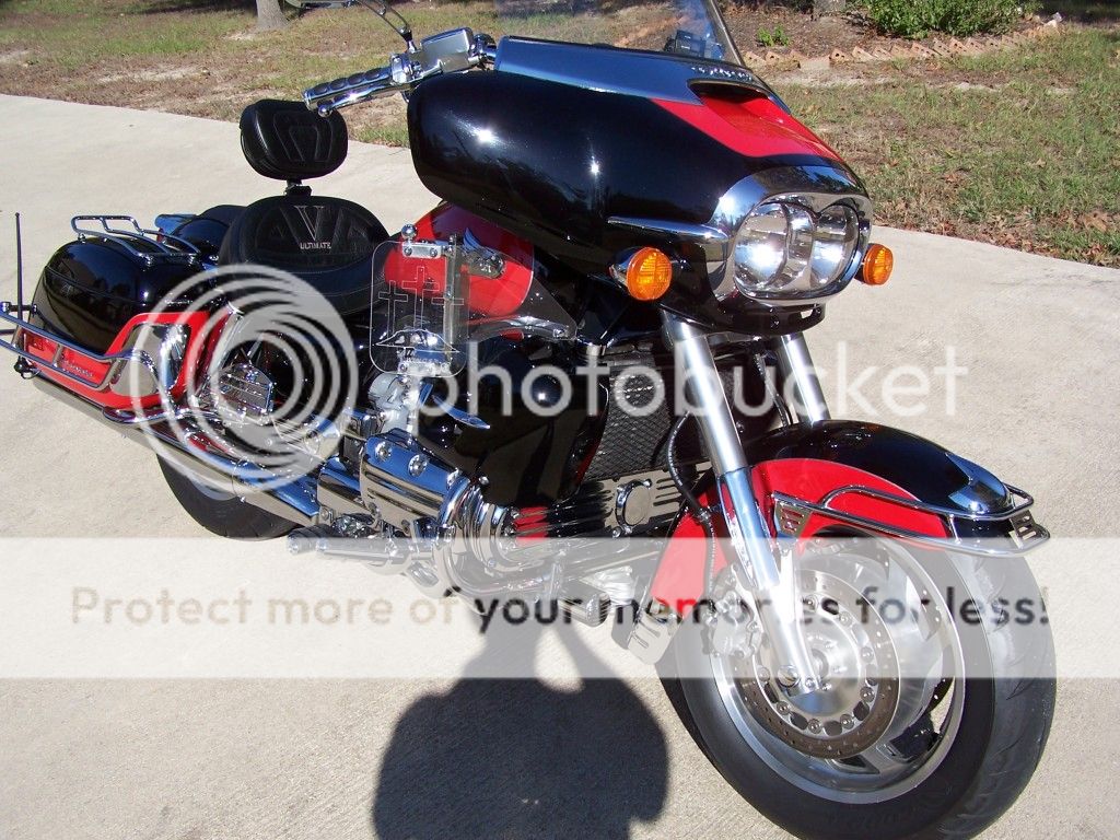

Bought a 1999 I/S about a month ago. have put about 2k miles on it so far and love it, but it needed some changes to make it mine. The first picture is as the day i bought it. The following were taken as I did my customization.

Are those Mustang seats?  I have to say they are kinda ugly with the trunk, but really bad looking nekkie without the trunk.  Id change that wire looking luggage rack for a sissy bar and OE rack.  I have always liked the IS with the trunk off but the ones I seen are mostly solo'd with the rack where the passenger pillion goes.  Two up is cool, just with no backrest and those seats its not working.  Is that plasi-dip on the fuel door?
Nice bike though.......keep it up

First off, sorry about the somewhat fuzzy pictures.
I spent the day yesterday installing the AirFlo stacks and removing the truck. I was not aware of what was involved, and it turned into an all day affair. First off, the exhaust tips from AirFlo are absolutely not bolt on, even after drilling the holes, which I knew was required. They would not fit at all under my bag. I had to modify both the passenger peg bracket mounting holes and raise the bags up from the mounting rails about 1/2 an inch. I raised the bags by adding several large fender washers under the 2 bolts at the bottom and elongating the holes in the rubber grommets at the top bolts, then sealing them with silicone to retain waterproofness. Once I had them mounted, I am very happy with the look though. I used Never-Cease on the pipes before sliding them on, and they went on easily asnd I was even able to spin them a little to line the holes up.
The truck removal was pretty standard I guess. I used a brake/tail light assembly I got from eBay that was advertised as for a Valkyrie, but was not at all. It was obviously from a Harley, as the mounting hardware was all SAE and it was the wrong shape. I am using it for now but will be replacing it eventually with a OEM Honda one. The luggage rack was also an eBay find, and fits nicely. The passenger seat will be coming off as soon as the fender bib I ordered arrives any day now.
I also replaced the windshield with a 10" light green tinted one from Cee Baileys, which was done in about 10 minuted and looks great on the bike I think. Due to the decrease in height, there is some increased wind buffeting, but nothing unbearable.
The turn signals had been wired as running lights by the previous owner, but he never changed the lenses to red. I modified them so they are red in the center and have a slight yellow halo that can be seen from the side. I also added blue gem inserts from an old Model A I had lying around.
The fuel filler cap and surround I painted flat black because on a sunny day the reflection was all I could see in the windshield. With the lower windshield now on, it probably isn't necessary, but I like the look anyway. It is Plastidip, so it is easily removed in the future.

The front seat is an Ultimate King BigBoy with the rain cover on, I had just finished washing it anf forgot to take the cover off for the pictures. The passenger seat is a Mustang, but is just there until I get a chance to mount the fender bib. I have a full set of mustang seats and the OEM seat with a backrest installed I may be selling, just want to put some more miles on the Ultimate before I sell the others. No sissy bar or back rest for me, I like the clean look of nothing sticking up above the seat level.

well ya, no need for a sissy bar if you are taking off the passenger seat.  It will look much better with that mustang thing off.  I don't think you will like the little luggage thingy you have on the back once the seat is off either.........to each his own
