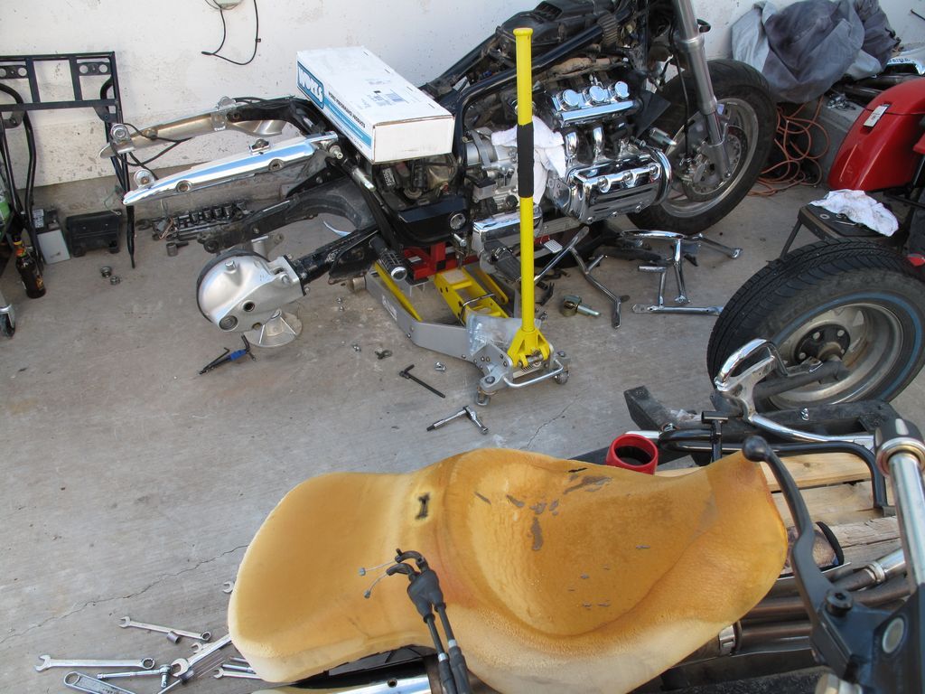

1.  Got the pipes off, crash bars, etc in order to mount the Sidecar sub frame and a few other things. All the plastics are off at the painters.

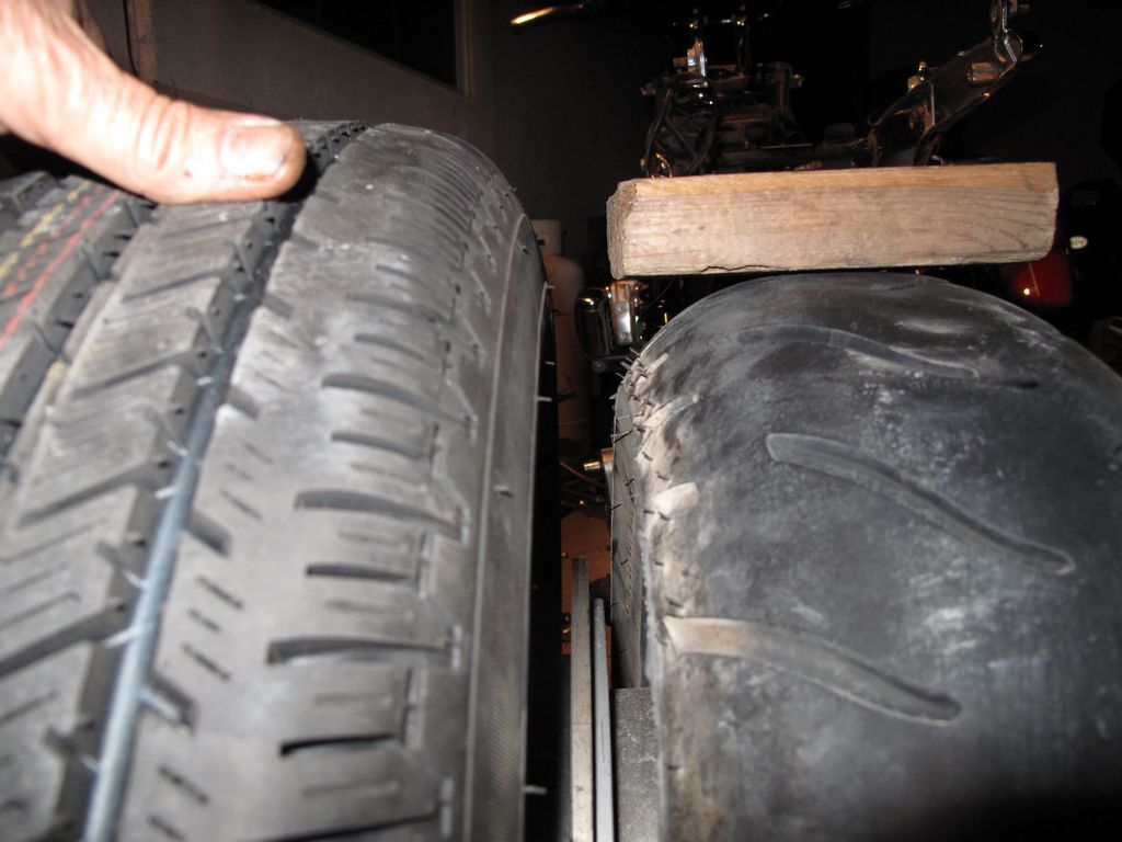

2.  Got the car tire ordered, delivered, mounted and installed.  Went with the Austone; used this on the HD hack and it has worked out great.  I read where it is about 2" larger od;  looks about right:

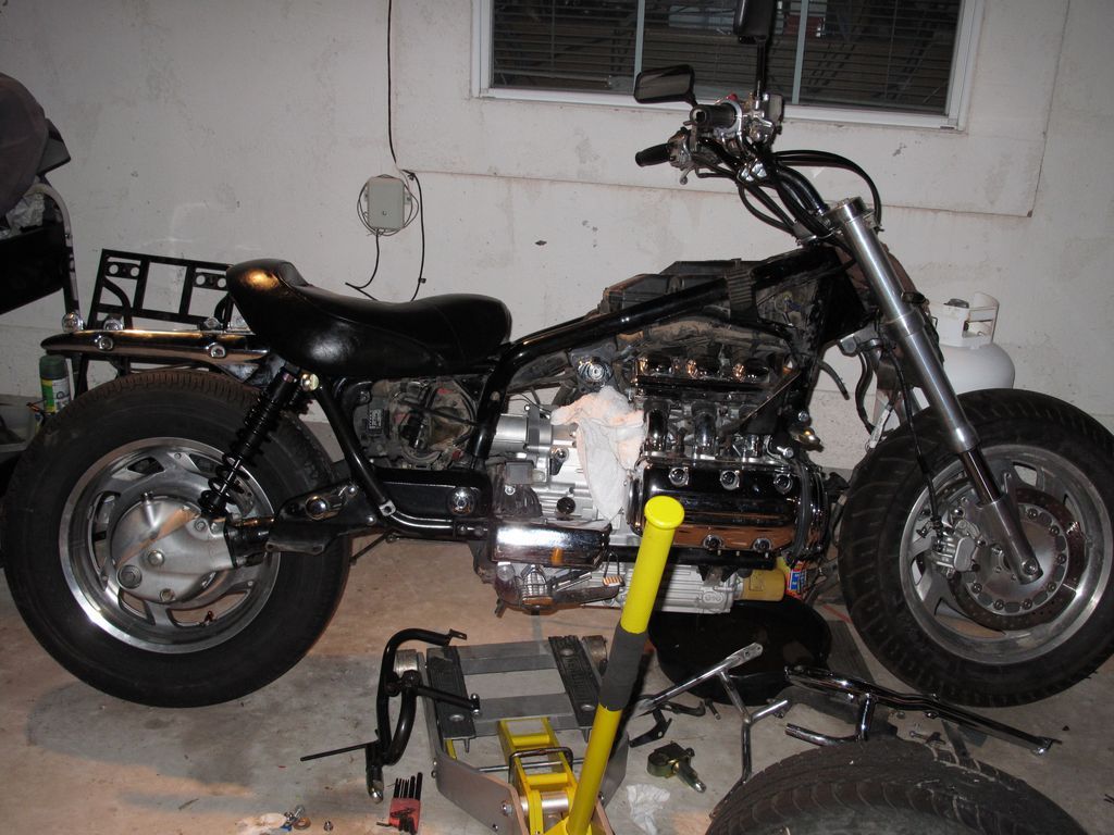

3.  Got the 1" over shocks from Works, and tonight got the shocks and wheel mounted.  Looks good;
reminds me of my 62 Ranchero in high school - first thing I did was put shackles on the leaf springs to allow bigger tires... Grin  But I lose about 3/4" when sitting on it solo, and the wife/sidecar/canine will suck up another 1.5", if I calculated right.

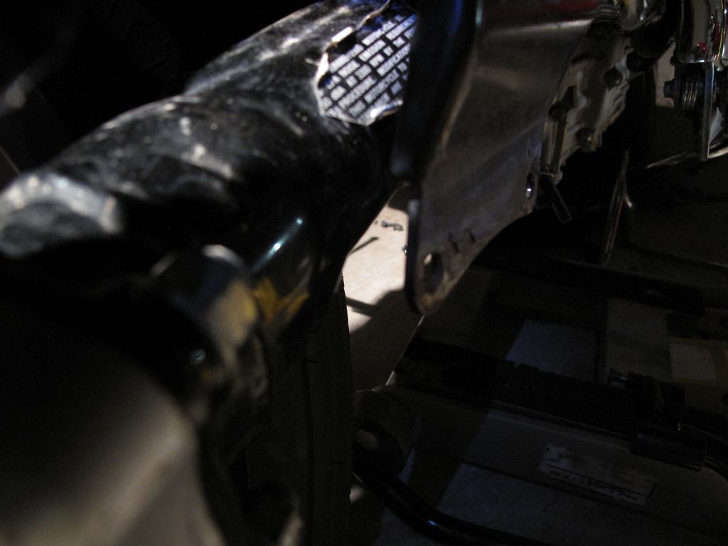

The greater swingarm angle just clears the exhaust mount on the right - no problem here:

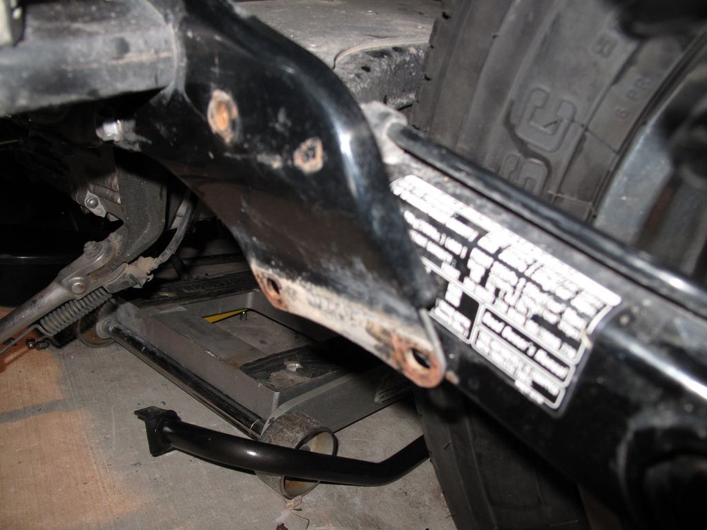

The left is a different story.  There is about 1/16" clearance twixt the rear exhaust mount and the swingarm; definitely not enough to get a nut on the exhaust bolt:
Was getting too late to keep working, so I'll hit it in the am.  Based upon the left and right exhaust dents/rash, and some saddlebag repair, it looks like the PO let it take a nap a couple times.  I'm thinking maybe the left mount is bent in?  It's an odd, compound bend shaped thing to start, so its hard to tell.
I'm going to mount the new pipe (ebay specials - take offs sitting in a garage for 14 years!) tomorrow, and see if I can just tweak or bend or space the exhaust mount out half an inch or so.  Failing that, I may need to weld a new mount in a slightly different area on the exhaust.
Any other ideas?

If you suspect that the mount is twisted a little, and it sounds like you have the ability and tools to weld a nut on the outside of this mounting point, and then bolt the exhaust onto the outside instead.

Thanks for the reply; it did appear to be tweaked, so a couple well placed hammer blows made it almost satisfactory.  It's odd, in that the tweaking seems to have come from the center hole, being pushed "outward, literally bending it in more than one plane.
With my corrections I now have about 1/16" clearance - not enough, but think I'll find one on ebay and start with a straight one.

I went with 14" I-I, and have about 1/8" on the right, and 1/16" on the left.  It appears both these can be made acceptable (1/4" or so?) by moving the stock muffler bracket higher on the muffler, and then re-drilling/modding the Valk exhaust mount.  I may try it as is and see if it is indeed a problem.
I also have about 1/16 between the muffler and the right shock bottom bolt.  I am going to find/have a friend make a shock mount bolt with an internal allen; at least this one should be an easy fix.
