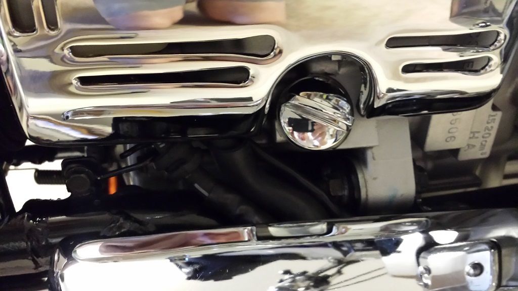

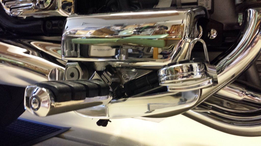

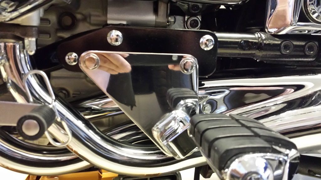

I installed on my 97 Std a pair of Horseapple Ranch Enterprise driver footpeg relocator brackets recently, and after 1000 miles in the saddle following the install, I like them very much. The bracket lowers the pegs approximately one inch and allows for the pegs to be about one or two inches forward. I went with one inch forward. The only slight negative for me was the rerouting/extension of the brake lines on the left side. There was slight tension left on master cylinder pressure line with the finished install, nothing serious. In my case, I saw no way of putting the bracket two inches forward on the left side because there was no more slack in the brake lines. It would have required relocating the rear brake master cyclinder IMO. The two inches forward on the right side would have been no problem. Also with the right peg forward, no adjustment to the shifting lever was required, in fact it was a more comfortable fit. My legs are more comfortable on the pegs now after long rides than before they were lowered. FWIW, I'm 5'10" and have a 31" pant inseem.
Left side, photo similar to those with the install instructions.
Right side, photo similar to those with the install instructions.
Right side brake lines and electrical loom, photo similar to those with the install instructions.

Glad those are working out for you. I put a peg relocation kit on my 2000 Tourer years ago. Mine was from Rattlebars and I think they have retired. My experience was the same as yours. I could go 1 inch down and 1 inch forward with no problem and that is what I did. To go 2 inches forward created rear brakeline problems that I did not want to address. I think you will continue to like them because they do improve comfort. BTW I have had no problem with my slightly stretched rear brake pressure line in well over 30,000 miles. You've got a clean machine there!  cooldude

Think you have your "right" and "left" mixed up. The brake is on the right side, not the left, etc.  Wink

I used a previous maker's kit (now out of production) as a template, then discovered some clearance improvements and applied them.  Also all the small parts are now stainless.  Per my measurements, routing the brake lines outside of the OEM wire tubing keeper should provide enough clearance to use the fwd position if you want to.   I don't have the kit on my bike, I don't have long legs so don't need it.  I did do a test install on my bike and it worked for me.  However there are variances from bike to bike, I've seen that in several places on many Valkyrie part installs.
So I do! Thanks John, I'll modify them.  uglystupid2
