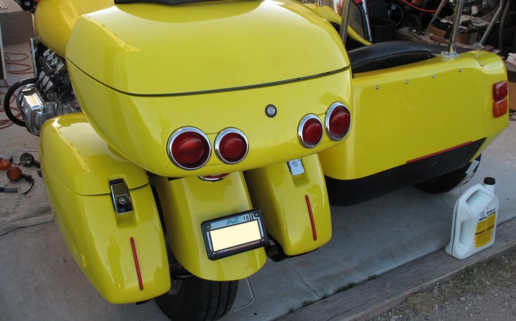

« Reply #7 on: January 03, 2015, 09:10:45 PM »
Not quite on the road yet, but I got some...
All from http://www.radiantz.com/ -  I think I've put some of their kids through college over the past several years...  License late LED frame also from them.
Just seen under the trunk is a Tourer tail light, with an LED replacement board and a brake strobe:
Inside each round trunk light is a 48 LED cluster: they are a pita to install, as the trunk lites have to be removed, and then totally disassembled - heat gun, screwdrivers, fabbing some foam spacers, etc, and a bit of time; there is a how to on the site that is pretty good.  I use them as running/brake.
