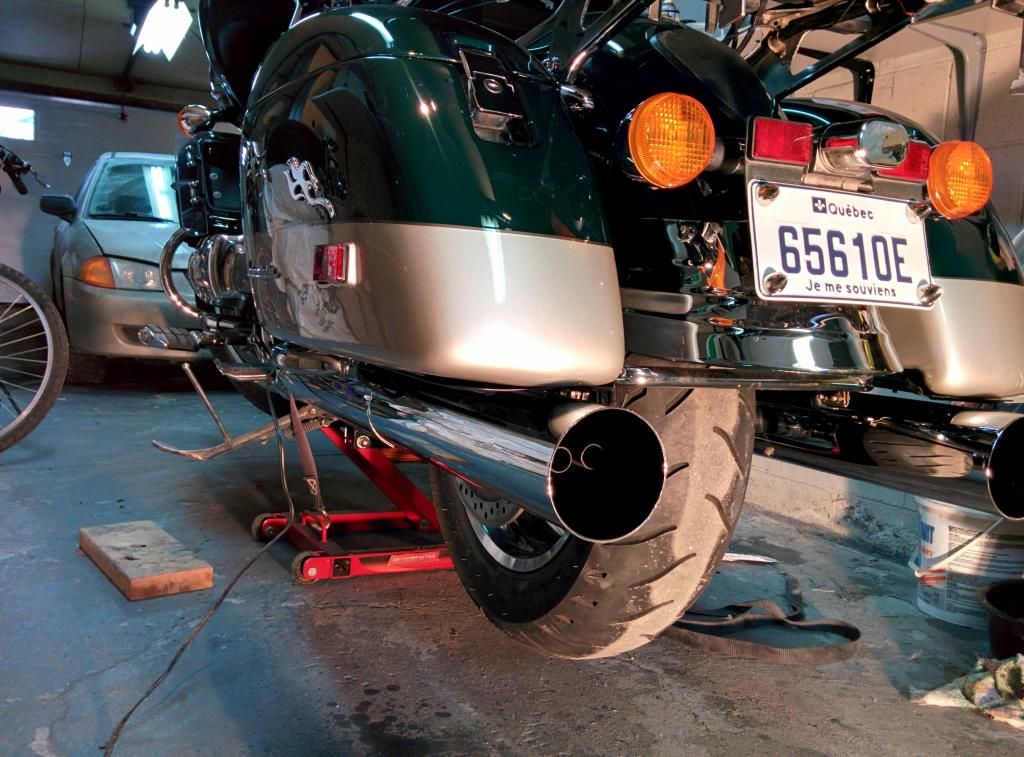

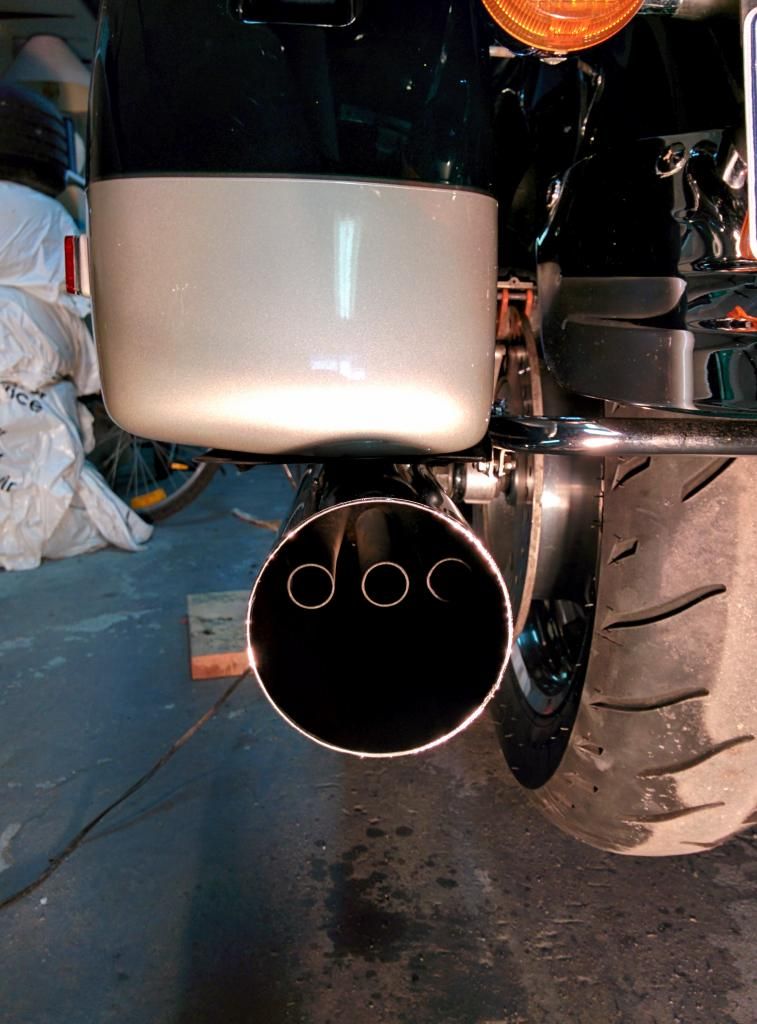

1/2h and it is done. The piggies are still in. No mod

Great.. I'm planning on the Stacks shortly . I will go with the 36" and cut the piggies.
Posts: 31095
« Reply #2 on: January 24, 2015, 12:09:02 PM »
I've done this too (18" tips).   cooldude    (Much nicer stock that the OE tips)
Note;  When brand new, I polished the inside for an inch or two on the bottom, but that was stupid.  However, it is nice to keep the flat cut, nicely chromed edges clean. If you let them go too long, it is hard to bring them back.
Also FYI, it is easy to scuff the bottom rear of the tips departing steep aprons of a gas station, leaning into the turn while still on the apron.  And if backing down with the tire touching the curb, you will almost always clear the curb on both sides, but it is easy to lean the left bottom tip on top the curb, when putting it over on the side stand.  And I have 13" shocks.

« Reply #5 on: January 24, 2015, 10:35:09 PM »
I went with 39" stacks with the rear baffles cut completly out. Then finished them with grumpys tips.

Looks nice.  On my to-do list.  I have both full 36" straight stacks and 18" turndown tips on the shelf.  Planning on using the full stacks.  Couple other things on the Valk list but brakes on the Wing will come first.

« Reply #8 on: January 25, 2015, 08:23:48 AM »
Yes I have a set of 36" on the shelf also  just haven't had time to put them on Undecided but I do have a set of Grumpy's tips sitting right beside them.

Any idea as to how this would sound compared to stock?
Interstate pipes have longer piggies than STD/Tourer pipes. Interstate
pipes are quieter. I like  Smiley ...
-Mike "but I have STD pipes with triple tips..."

« Reply #11 on: January 27, 2015, 10:04:51 AM »
Did not try at this moment. But i think there will be no noticeable difference.

« Reply #12 on: January 27, 2015, 10:08:01 AM »
Those stacks are about 3'' longer than OEM. Not sure the 36'' will give a longer exhaust than just the 18''.
Sure is much work. Does it worth it? Not sure

« Reply #14 on: January 27, 2015, 05:44:56 PM »
I have the 18" slip ons.... just had to drill the holes in the stack and bolt on with original holes...
Easy Peasey

« Reply #16 on: January 29, 2015, 08:12:37 AM »
 I have truck stacks on my bike and the one I am re-building will get them as well. I like the looks of your bike. I used turn-downs on mine. I made an extension arbor for a holesaw (5/8?) that just fit inside the piggies and cut the baffles out one at a time until I got the sound where I wanted it.
