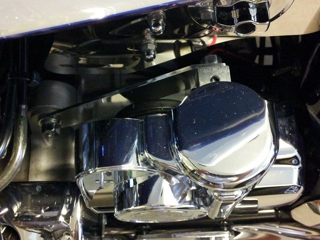

I just completed installing a Pro-Lift permanent lift adapter, like everyone here that has installed I also love it.   cooldude
Next project is to mount and wire a "newer" Stebel Compact air horn.  I have read here that some have mounted using the Pro-Lift adapter, true?  If so, can somewhere please share their experiences and of course any pics would be VERY helpful as well.

I made the mount out a short piece of aluminum I had laying around
Posts: 30975
« Reply #2 on: February 17, 2015, 07:07:20 AM »
I had my stebil mounted under the swingarm; mounted to a square steel plate, with the steel plate mounted by two long hose clamps to the swingarm. I use a wood adapter and it did not interfere with my lift (mounted behind the lift and adapter).  But I had two stebils die early deaths under there from eating too much crud/mud/water.  So I didn't put another one under there.

I mounted my Wolo Bad Boy where the OEM horn was mounted on my Tourer, facing forward.  The compressor part is tucked behind the radiator.  It took some effort creating the aluminum mounting bracket.  It's a good location for sound output but the horns collect bugs.  You can see it if you can expand my profile picture on the left.

I mounted my Wolo on Jade here on the right side of the tranny case.  Only needed a little piece of aluminum strap material.  Used a standard auto relay and wired it through the PC-8 fuse panel.
