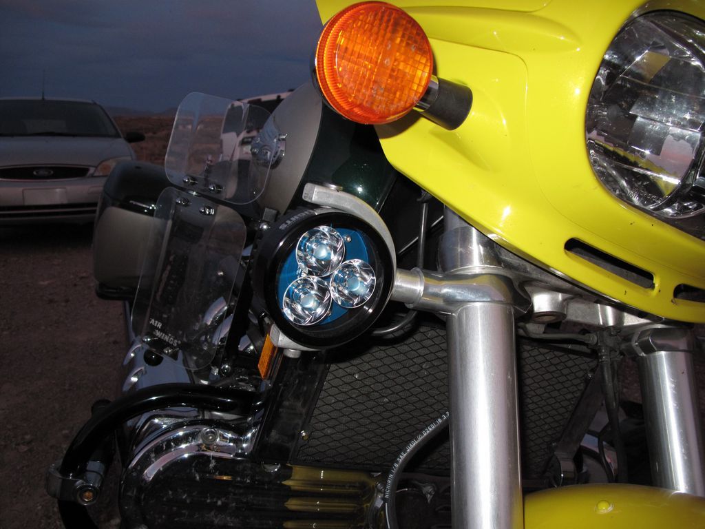

Clearwater Krista's.  3000 bloody lumens!  Each!  Wifey got em for me for Christmas, and I'm just getting them mounted.
Unfortunately, for a marvel of lighting they came with a stamped steel pos mounting bracket, and it took me a bit to design and fab a replacement.  6061 cut gross (square) with a waterjet, and then NC final finishing.  Did not like mounting on the crash bars, as there was a lot of light reflected back/scattered/and blocked by the fork and fender.  Enlarged the ID of the Standard turn signal stalks to let them slide up the forks as a mount.  Used a brake rotor bolt for a low profile 8mm allen on top - still need to change the bottom bolt.
Still need to get electrical squared away, and I think for Mod 1 I'll make the stalk of the light bracket (1") match the fork mount (33mm), and then get powdercoated.  I think it turned out pretty good... Cool
