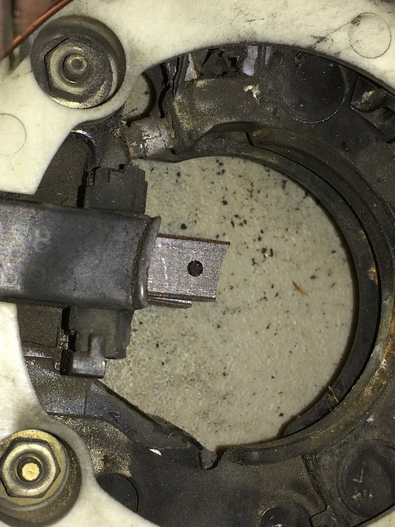

Hey guys. On the recommendation of another member, while I was waiting on other parts to plug the engine back in I decided to pull the alternator apart and clean and check the brushes. Here is where they are now. The wear indicator is right at the edge of the housing when disassembled. Do these brushes need to be replaced?
Thanks for the input and feedback.

You will probably get a year or two out of those brushes. But as long as you have come this far, I would replace them. It's cheep and easy.

You wear through the holes before you get to the minimum wear indicators. I don't like hitting the holes. I use the hole as the safer wear indicator so Id say you have a 5-8K miles left on them. But as said, they are so cheap and you are there, why not change them.....

OK.. Thanks guys. New brushes are already ordered but waiting on them delays me putting the engine back in again.

see my posts, the wear limit line is 3/8" past the holes, so u have many, many thousands of miles to go. make sure u clear out the rear bearing
