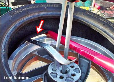

I'm using a mojo lever, and I can't seem to pry open a gap large enough to stick the nylon tip of the mojo lever between the tire bead and the rim. Again, this is on removing the *second side* of the Rear Tire. Also, with a HF tire changer. I've tried angling the tire every angle. And at every elevation in the wheel valley. What is my next move?

Status report .... I've arrived at the point that I'm contemplating hack sawing the tire off the rim already. I have a Sawzall with a metal cutting blade, so it's plug n' play. It's just that I usually rather do things the civilized way. Maybe give it two more days. Below is the abominable *gap* that I'm looking for (arrow). My setup next pic. The tip on the mojo lever is ¾-inch diameter. Oh, I did manage to get the mojo tip under the second bead by positioning the entire second bead level all around in the very middle of the valley, the most narrow circumference. Bead hooked to the mojo, only to then find it impossible to pull the mojo tip high enough up to leverage the mojo around the center post, alas. What makes this so aggravating is that all it takes to get any tire off the rim is to remove about a 90° sector of the tire from the rim and the rest of the tire just falls off by itself. Well, you're loosening it, so it should get easier *if you ever get it started*, for example, as opposed to installing a new tire on the rim, which makes the last 8-inches the tightest sector. I did the front tire last month and it took 20 seconds each to remove the first and second bead.

After pulling the tire up the rim, I'm unable to pry a large enough gap to stick the spear through the available gap to hook the second bead. That's a ¾-inch gap even using 16-inch spoons. But then if I start with the barb hooked to the bead with the bead circumference level with the middle of the wheel valley, plenty room there, I just can't pull the pre-hooked bead up the rim inspite of using a spoon to keep the slack or wedging a piece of plywood as a makeshift doorstop. I am currently working on the later method with marginal progress but am more than convinced that it can be done perhaps disillusioned there indeed exists a missing step that then can be replicated.
