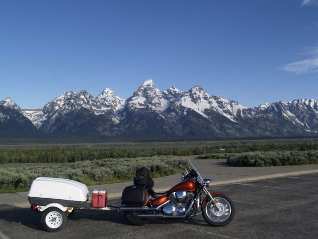

My Escapade trailer came with the ice chest mounted on the tongue of the trailer.  This is to keep the weight to the front, like everyone has already said.

I have a trailer almost exatly like Chrisj's...maybe even the same thing, but different tail lights.  It is a Kompac-Kamp.  Anyways, it will start to sway at 60mph or so when lightly loaded or empty.  It tows best when the cooler is on and full of ice and drinks/food.  Then it is good to 80+.

I will agree that you would need more tongue weight... thats where I carry my cooler and it tracks nicely....
